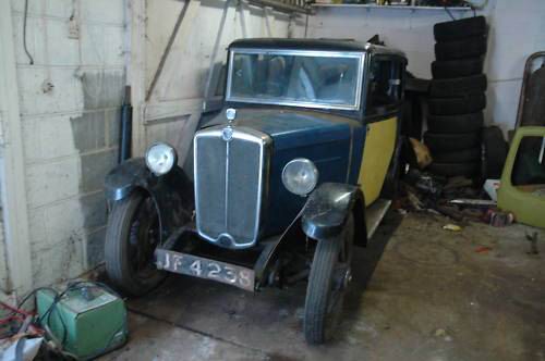

Hi - I am sure that I have broken all of the rules of sensible restoration; bought a Minor off eBay on a whim; without a master plan, I have stripped in down it to lots and lots of bits! Of course I did get a lot of enjoyment out of taking it to bits - I am sure that I will remember where most things go!
The engine came without pistons and con rods connected, but with a collection of 4 rods an pistons that did not belong to the engine. Is it possible to source good con rods and new, oversize pistons?
I am having trouble removing the flywheel, nut removed + puller made; any tricks/tips? Also looking for a good passenger side door + interior?
What threads are used on the head nuts, the big ends and the sump? metric ??

For the benefit of others, here's John's new acquisition:
