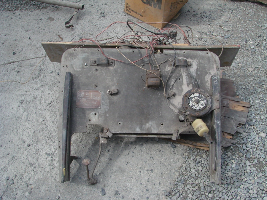

:D Hi all, has anyone a photo of the firewall and position of things theron,
I have just had a new firewall made minus the holes,
mine had that many unused holes and I would like to do away with,
like for the coil ect ,
any help would be welcome if you can not post on this site "LIKE ME" you could send to my email as fol.,

Hi Colin,

You should have holes for:
Scuttle shroud
Scuttle side supports
Pair of radiator tie rod supports
Pair of floor board supports
Throttle cross-shaft
Steering column bracket
Chassis plate
Cut-out
Hole for fuel pipe
Holes and slot for slow running control
Holes for SU fuel pump (originally a Petrolift, you probably have the later SU)
Hole for wiring
Junction box
Oil can clip
Have i forgotten anything?
Here's a couple of images which might help:
First is from my McEvoy (1933 season):
And this is from a slightly earlier Hundred Pound Minor - with scuttle tank:
If you can e-mail me a pic of your scuttle, I'll be able to provide more specific advice and post it here.
