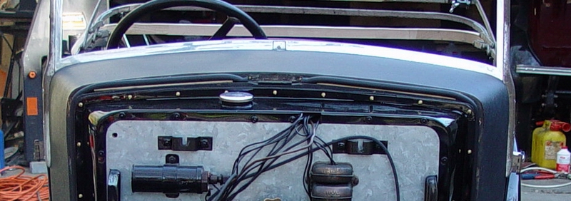

I found this photo which shows the problem I had. Note the two thin wood strips to support the rubber section. Something I need to sort when I get the car back over here later this year.
Here's another, showing the brass P-channel strip that protects the scuttle fabric on the fabric models:
