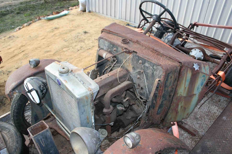

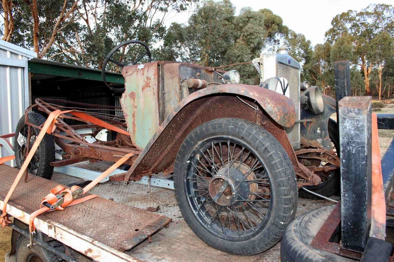

Well she is home at last, just got to get it off the truck. Back brakes are siezed. Twas easy to drag it on with the winch, unfortunately cant drag em off with the winch. Anybody out there got a spare dashboard??

Blimey! Good luck, looks like you've a fair bit to do! :shock:
Re: M18904
Blimey...........
you may not be able to 'winch' it off..... but you can tie another vehicle or a tree to it and gently ease the truack away....!!! it's not like it'll run away with itself if the brakes are that well seized!!
Re: M18904
Well I think it is going to be a great project. Bruce has parts of two other cars, plus a roadster body, and I KNOW he'll get all the help we can muster through the Register.

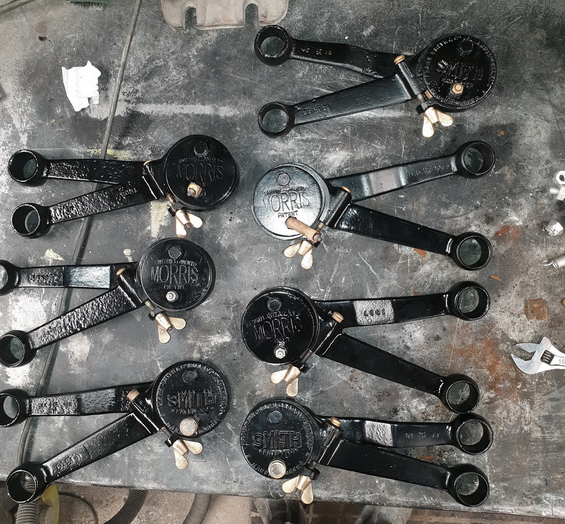

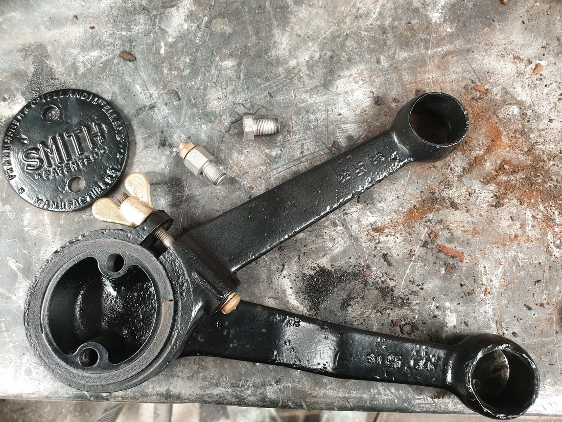

At Last after nine years work has commenced on M18904.
We have stripped what was left down completely, Chassis has been blasted and powder coated. Radiator has been recored. Leaf springs have been blasted and painted, and reassembled, axles stripped and painted, brakes stripped blasted and painted. And yesterday was rebuilding the Smiths shock aborbers. I have fitted buffalo leather linings. Will try grease free initially. We have 7 to choose from. I assume the early cars had "Smiths" and later cars "Morris" shock absorbers. Is the change date known? And does anyone know what was the correct greasing nipple for them see attached photo for options that I have.

Congrats Bruce. These Smiths shock absorbers look like a work of art!
Good luck with the rest of the restoration.
