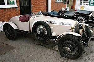

I think James Peacop is already giving the ulsters a run for their money in his M type special. He was quicker than all the unsupercharged sports ulsters and most of those in the racing car class at this years Precott. It would be great to see a more equal balance on the grids though - there is already a great friendly rivalry among the ulsters.halbe wrote:Would't it be fun to give the A7 ulster body a decent chassis/engine and than give them a run for their money![]()
The beauty of ulster bodies is while people all start with essentially the same body all the cars end up unique by the time they are finished - some are out and out racers while others are tourers or both.
The angles chosen in the original publicity photos for the £100 minor certainly look very sporty but from other angles it can look a bit fat. They may not suit a racer but having said that there have been many a A7 chummy that has been stripped down for racing and they I don't think they look too bad at all. After all the A7 supersports was based on a chummy.
Perhaps any new body design should allow for a modified lower longer steering rake in the same way ulsters do.
