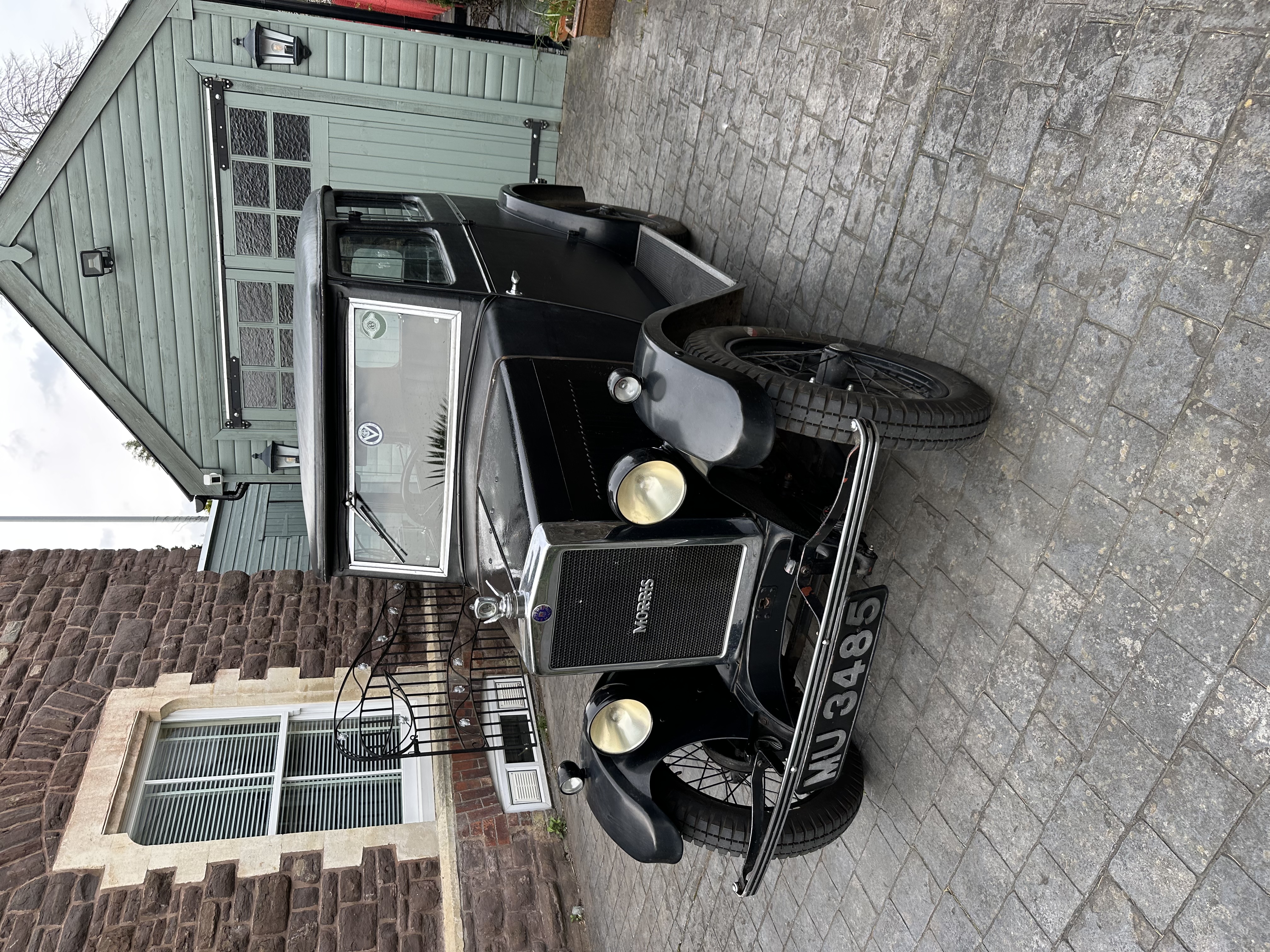

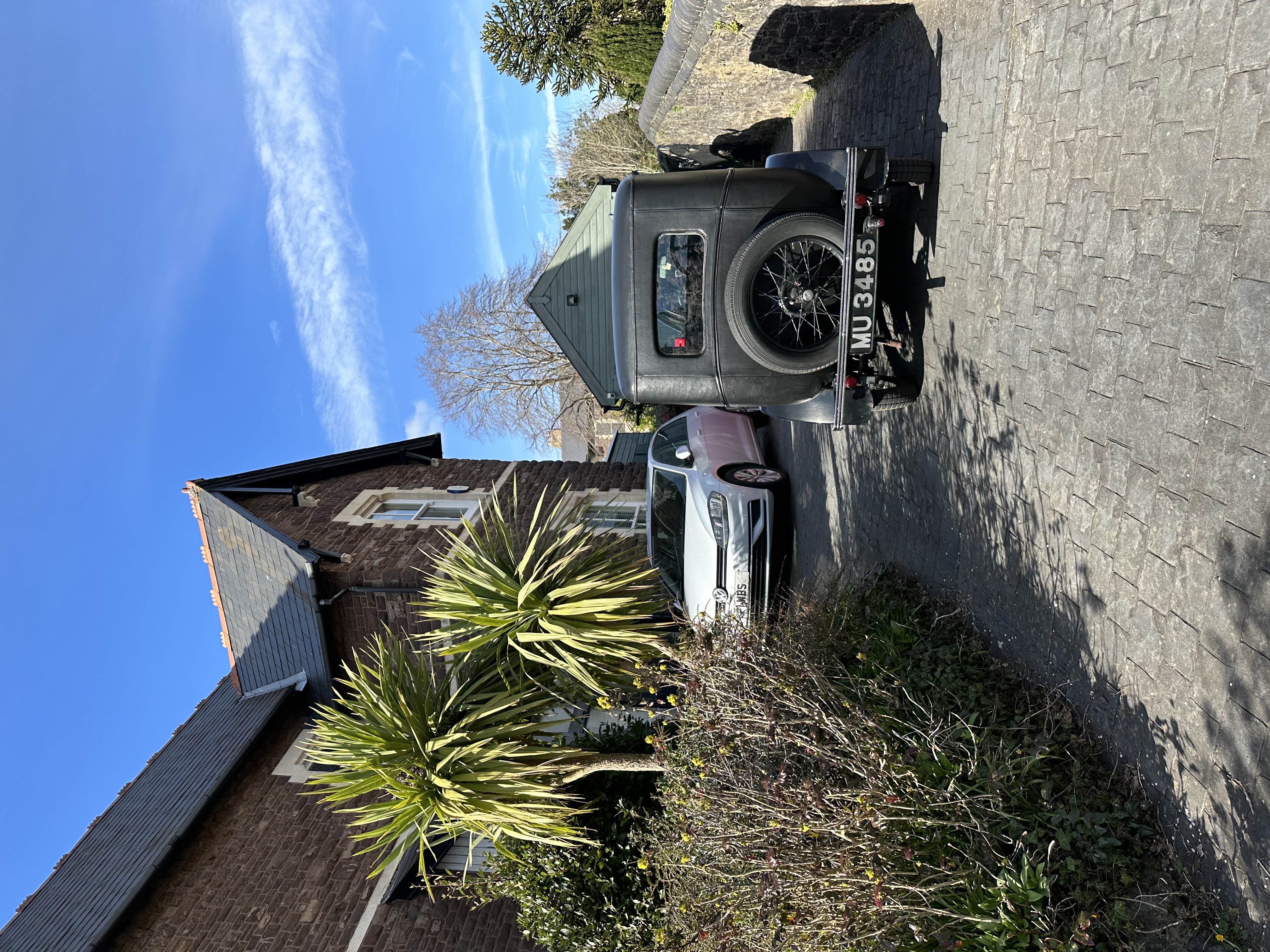

MU was my father’s car, which I inherited. It resided in Oxfordshire until I moved it to Newport, South Wales in March 2023.
I’ve included a couple of photos of MU in situ at the new residence.
Currently issues noted in the last 200 miles of running since the move:
- starter not working - related to this I sheered the starter handle but have repaired this with a somewhat bodged job of an old impact driver bit which fits quite nicely. I have also had to leave the front engine mounting bolts slightly loose to get the starter handle correctly seated to start - I suspect I need a couple more spacer washers or equivalent underneath to hitch the engine up a little.
- occasionally tricky getting into 2nd gear on the way up the box - have to give the gear knob a slight tilt and twist anticlockwise and it’ll eventually sort itself out
- distributor cap from the magneto is live (found that out the hard way)
- horn appears faulty
- obligatory squeaky brakes
It would be great to have advice on standard stuff: oil, filter, spark plugs, battery etc. to do a basic service on her since her time off the road.
Other than that she runs wonderfully when she’s going. Any thoughts or comments very welcome.
