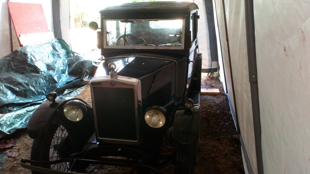

A friend of mine has the task of reviving his late father in law's out-building stored, untouched for 11 plus years, 1931 Minor two door saloon.
Apparently, it was in superb condition prior to being stored, but has suffered a little during its long slumber. The most immediate issue is getting it to run and hopefully drive too.
So far I think we're passed the stale fuel stage, we've tested the electrics but haven't really been able to completely rule out plugs, HT leads, distributor cap, rotor arm, points or condenser as possible weak leaks as these probably need to be substituted to eliminate them. We have a new coil and battery though and plenty of 'Easy Start'. I haven't dismantled the carburettor yet, but am wary of ripping everything to bits as that carries significant risks with 90 year old parts. I don't want to smother the car with enthusiasm and make things worse in the process. I would hope that the Easy Start would have provided some pops and bangs and perhaps even a short burst of life even if the carburettor was lethargic.
The starter is still a little sluggish (less so now that we've cleaned and tightened the connections). The battery is new and matches the one that was removed, but is only about 58 amp hour. I understand that the 80 amp hour alternatives are preferred. The engine now turns over on the starter (as enthusiastically as any 6V starter, I suspect), but the spark is pretty feeble. The car failed to start last time it was moved (many years ago) and sadly, it has yet to run for us!
Ian Grace has suggested that I start this thread and post some pictures. If there are none to be seen, then I won't yet have been up to the technical challenge of uploading them, but I have been promised assistance if required!
I have a fair bit of experience with 1960s cars from my early days as a motorist in the 1970s on a young man's budget. I have also carried out quite a few tasks on my daughter's 1953 Riley RME. However, pre-war cars with six volt electrics are a new challenge for me, especially as my old school 12 volt diagnostic tools can't be used (dwell gauges, timing lights and the like). Well, it's a challenge!

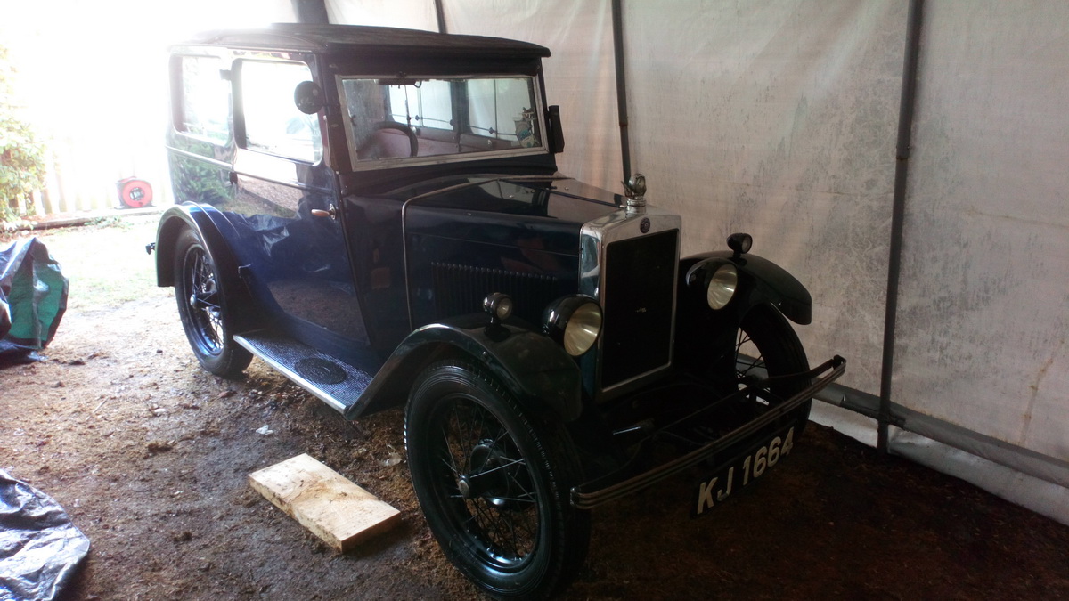

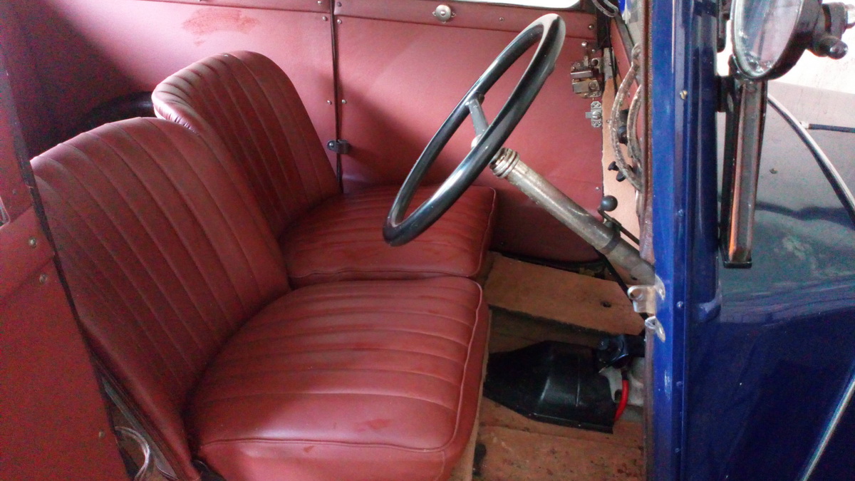

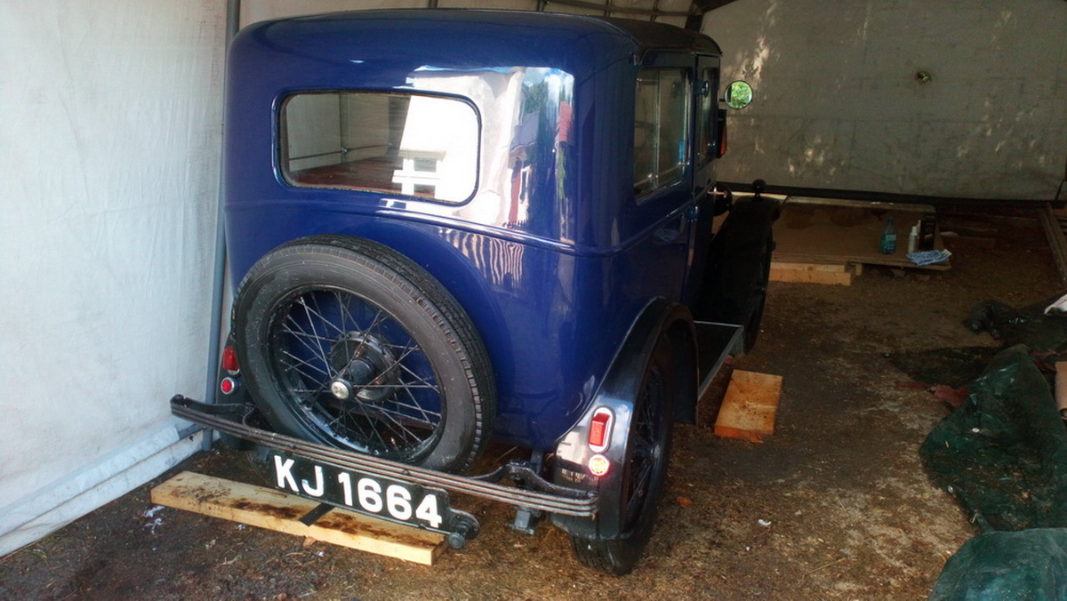

Photos sent in by Philip:
Re: Two Door Saloon (OHC) KJ 1664
Looks like you got a bargain Philip!

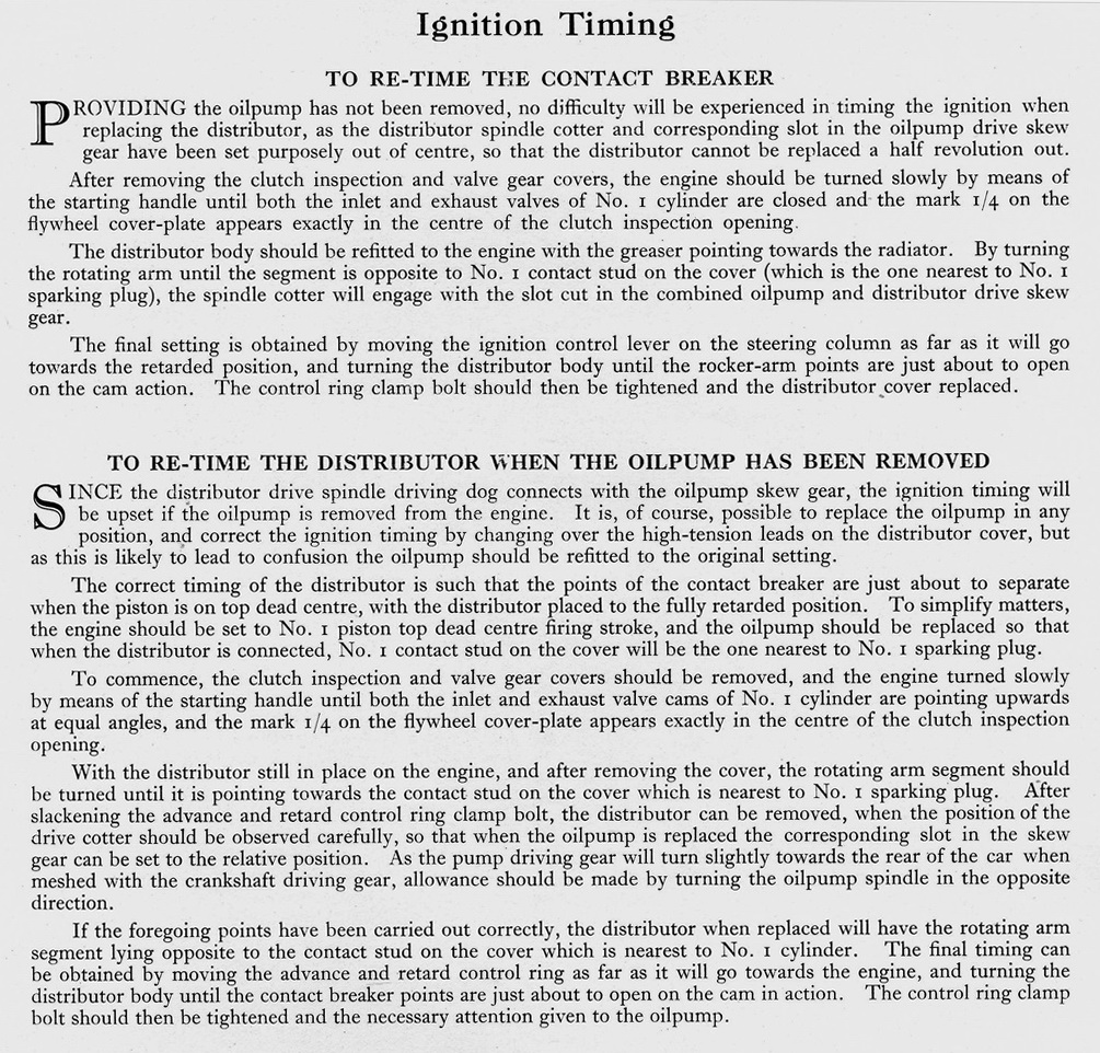

Here's the SV ignition timing, taken from the original SV Minor service sheet in the VMR Members' Area. Should be good for the OHC engine as well, I believe.
Thanks for resizing and posting my pictures, Ian.
The other picture looks like a recreation of a second hand car lot, complete with appropriately dressed 'spiv' - presumably at a car show? Is there any more information about the circumstances of the picture? £95 would indeed be a bargain.
Thanks also for the ignition timing instructions. Looks straight forward, with not a dial gauge or strobe light in sight!

Another image that shows the usual distributor orientation for No. 1 cylinder with a DJ-4 distributor.
Your car may be different but if the firing order and plug leads are correctly connected it will work whichever way it's set.
On my car the distributor is turned so the rotor arm is at 1 o'clock rather than 11 and the flat edge is more vertical.
Does your distributor have a round base without a flat edge? I think a DSR type was fitted to 1930 OHC Minors.
Peter, in a word - brilliant!
Thank you so much for taking the time to put together a step by step guide. Whilst I am familiar with the process of static timing, pre-war cars and the Morris Minor in particular are outside my comfort zone. Two points in particular may well provide the 'euraka' moment:
The first is the description of the rotor arm positioning and the 20º timing method. This will hopefully give me the confidence to have the courage of my convictions when setting static timing and checking the leads/cap/rotor arm alignment.
The second is the position of the distributor clamp bolt (the picture was a real bonus). Mentally, I couldn't get past the moving advance/retard plate as it was outside my experience and I completely missed what should have been obvious. I believe Homer Simpson would say "d'oh"!
Thank you again for your posts. I had pretty much resigned myself to defeat, but I now feel enthused for another 150 mile trip!
I will indeed keep everyone posted.
As a quick aside, if anyone watches the 'Furious Driving' channel on Youtube, Matt has recently posted a short video about a 1930 Morris Minor: https://www.youtube.com/watch?v=PZBFR-jxb9U. Matt has a very honest and disarming style, well worth viewing.
