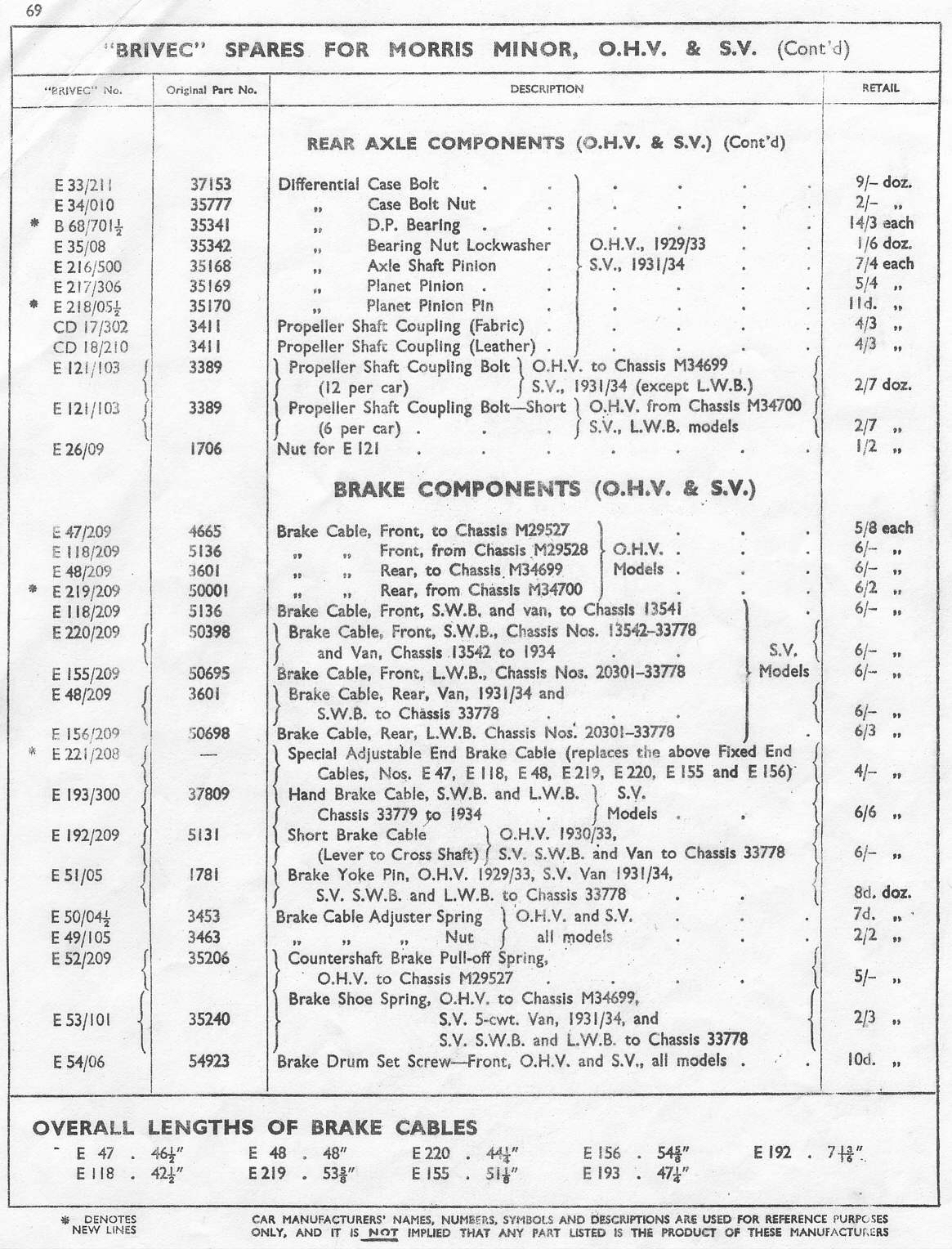

Here's the relevant Brivec catalogue page, giving all of the cables and "overall" lengths:

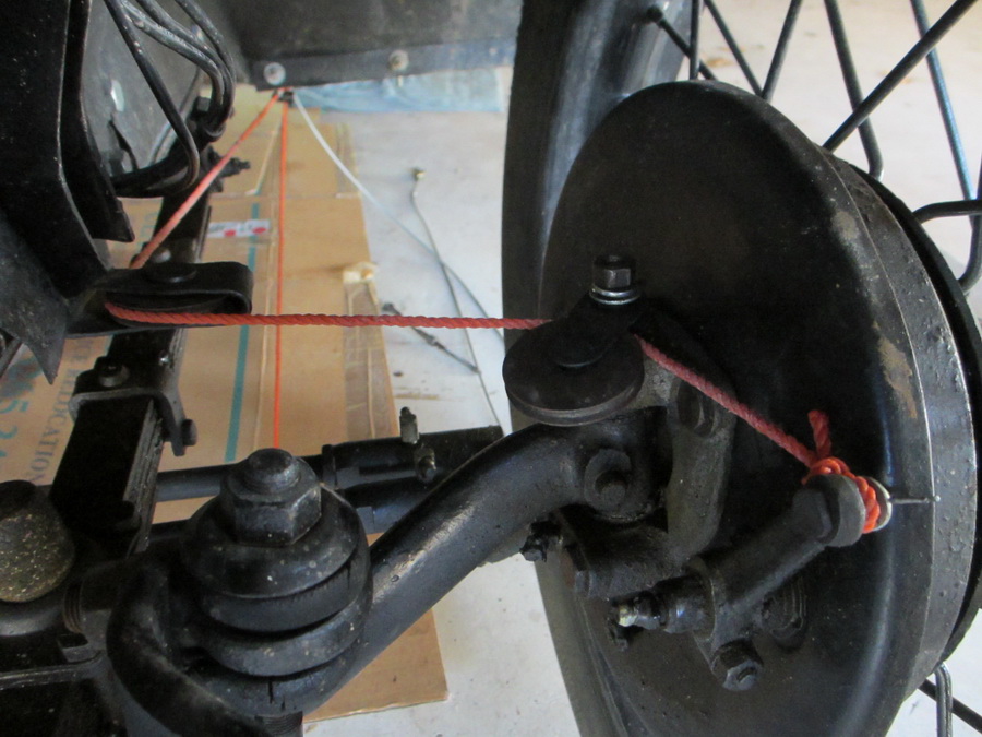

It occurred to me while I slept that I should have used a piece of string to determine precisely the distance from the clevis pin hole in the front brake cam lever, round the two pulleys and back to the cross bar clevis pin before cutting the cable. We are away on Stradbroke Island for a week or ten days but I will certainly carry out this task when I return and before making any further decisions. At that time I will photograph the pulleys and their mounts for you but I am pretty sure that this isn't the problem. The idea that the front and rear cables are of different construction is new to me but of course absolutely sensible. Can you let me have some indication of the diameter and composition of each that you have found successful?

I've contacted Ian Harris and he has given me useful advice about cable diameters...3mm or 4mm from his supplier. My cables measure 3.8mm but are of a composition that doesn't allow them to turn around the pulleys without bowing out and hence shortening the available length. My cable length measurement (how long is that piece of string?) comes in at close to 42" with brake cam lever and cross shaft at maximum off position. Too close for my inflexible cables.

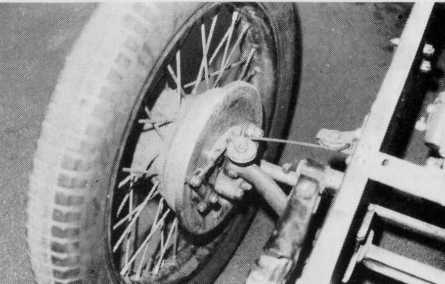

This afternoon I remembered that on October 31 you asked "Could it be that the chassis pulley brackets are wrongly positioned on the chassis....?" I replied was that I didn't think that this was the problem. I have now noticed that the early SV lubrication chart clearly shows the front brake cable passing through the chassis pulley at something well beyond the 90 degrees that the cable turns through on my car.
I've just been to look and there does seem to be another mounting position further aft. I'll have a better look tomorrow morning but even looking at the photograph I posted this morning it seems that my chassis bracket might, as you anticipated, be too far forward "thus lengthening the cable run".

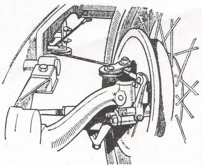

Thank you for the drawing. I've been reading a forum post on this subject from early December 2010 (JF 4238 Minor Saloon). You comment on December 5 in that series that "..it certainly looks like the chassis bracket on the SV car is mounted further forward than on the OHC car". You don't identify the source of the photograph illustrating this or the date of the car but it does raise some more doubt in my mind.
I'll be glad to have your observation of where the brackets are on the McEvoy. There are so few Register cars here to check these things. My strategy this morning is to wait for the new cables from Ian Harris and then, if they still seem too short, look at moving the chassis brackets.

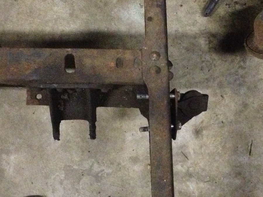

This one I just took with my cellphone out in the garage. It's the McEvoy chassis and I loosely hung the brake pulley bracket on the chassis. The photo was taken directly above the pulley. It looks like the pulley centre should be virtually perfectly in line with the aft edge of the front chassis cross-member.
(Note that the 1933 pulley bracket is a little broader/stronger than your earlier version, but the position of the pulley wheel should be the same.)
