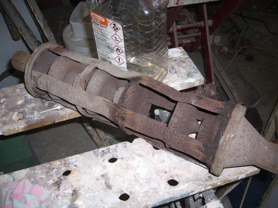

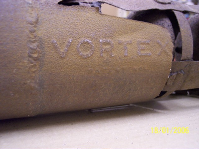

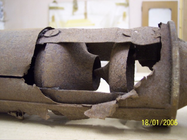

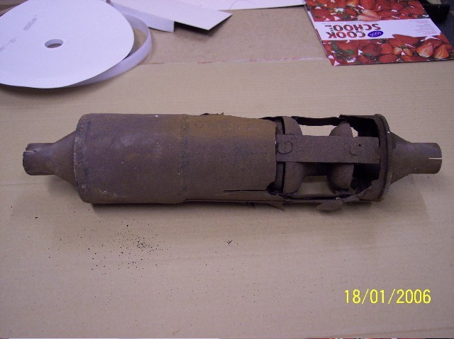

If you were being purist you wouldn't have much luck since the original silencers haven't been available for many decades. It seems two makes were supplied, Burgess and Vortex. I don't know how the Burgess is made or what one looks like, but the Vortex appears in many period photos. I have just had one repaired just to hear what it sounds like; I intend to take it off again and cut it up so that I can make a new one.
It has not been on long but I now know it is about as effective as the straight-through it had on before but much quieter. As the name implies, it contains a series of interlocking cones which induce a vortex. It is much larger than the silencer supplied by S+V. I will take some measurements later on and post them.
I'll see if I can include a photo - my attempts so far have been 'invalid'!
Re: M Type exhaust silencer/expansion box.
Ian just sent in this picture of his Vortex. The other three images were sent to me by Ian in 2006 and were published in M 124.
Looks like quite a complex piece of kit to replicate - more like a wind instrument than a silencer!
Minors were fitted with conical-ended silencers that had much simpler internals, and replicas are available from the Cooke Group.

Ian, thanks for putting those photos in. I had forgotten about the earlier ones. For anyone looking for a similar sized one, the length of the barrel is 15" and the diameter 4.5".
