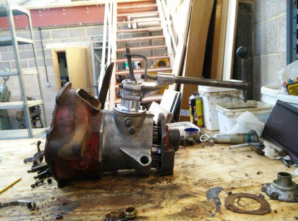

Stripped the box and had a fiddle, not sure what I have done but now have four forwards and reverse, an improvement!!

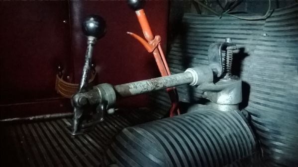

Just as a matter of interest a contributor to the MG Triple M Forum on a theme entitled "M type 4 speed with Derrington remote" has put up this image -
I am not sure if it is a Derrington example but I noticed the similarities with the example which appeared earlier on in this thread fitted to a McEvoy.
I hope I can be forgiven for sharing the image above on the Triple M site.

Posts: 5043
Re: A gearbox rebuild
Thanks Sam,
The lower image of the McEvoy box is that fitted to Sarah Gibson's car that she brought to our Pre-War Prescott in July. It certainly does look very similar.
McEvoy adverts included remotes but I have never been able to determine whether they were of their own manufacture or if they were simply an agent for Derrington, etc.
My McEvoy definitely has a Derrington fitted, but who knows whether the car left McEvoys' with this one fitted.
No problem sharing the photo on the MMM forum.

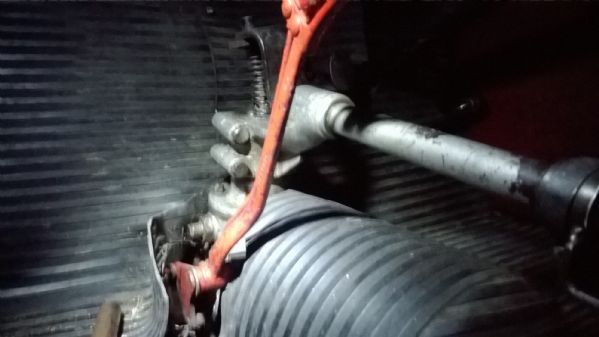

Jeremy Hawke has taken a couple of new pictures of Sarah Gibson's car which he has put up on the Triple M Forum (Jeremy says the car is about 50 yards from where he lives). The photos show the remote without the 'upholstery' and it seems clear that it is the same design as the one on the Triple M Forum.
The design is cleverly minimalist but I cannot help thinking it would be rather greasy in use. With the exposed parts polished or chromed as appropriate it might look more stylish but I favour this Wolseley Hornet design for looks.
Post by PeterWHills »
Hi Ian, I was looking at this despite being 3 years back so what happened? Did you strip the box or not? As you have seen from my articles it is not so difficult to sort out. The plastically deformed splines on the spigot shaft do not look serious, quite normal considering all those I have seen. The wear that needs attending to is more likely on the lay shafts. Some times they are seized on their bronze bushes that turn in the gear cluster instead. Replacing the bearings with sealed type is also good practice, especially the rear stopping oil leaking out. Let me know what you did.
