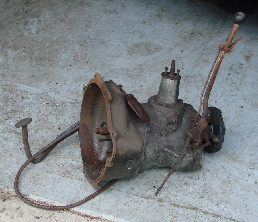

Having stripped down the McEvoy last weekend, I now have the gearbox sitting on the garage floor. It is a 4-speed crash box with Derrington remote and I plan to completely rebuild it. However, having owned about thirty Minors and rebuilt several of them over the last 35 years, I have never stripped a Minor (or any other) gearbox. So I thought I'd tackle it myself instead of sending it out so that I can learn how it is done. Then I thought that it might be of interest to record the rebuild in detail here on the forum, with photos, etc. so the thread can build into a reference for future rebuilders.
But I will need help. So first, has anyone here rebuilt a Minor box before, and could anyone point me to any reference material that might help - in the MMM Yearbooks perhaps? Later today, I'll post some photos of the box and remote as they have come out of the car. All input, suggestions and comments most welcome.

Let's hope I don't regret pulling this one apart!
So here's the starting point:
The first task will be to remove the handbrake lever (which is slightly bent), the old fabric coupling (I have a new hardy Spicer prop shaft to fit), and then the serious dismantling can commence.

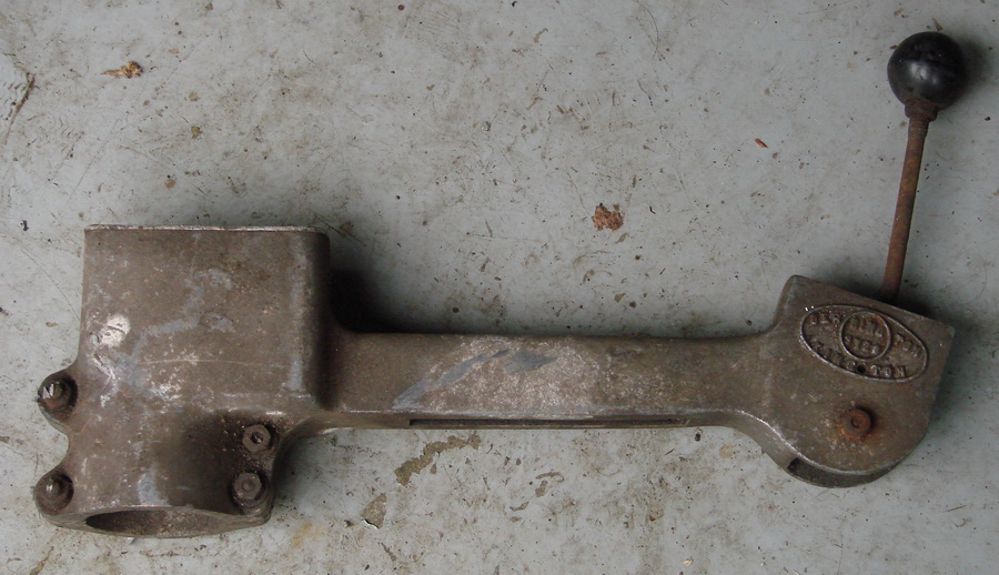

And here is the Derrington remote.

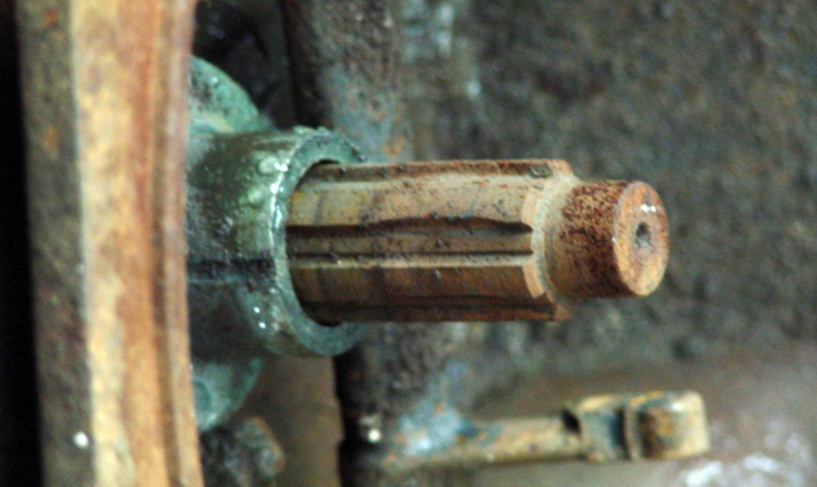

Interesting angle, and one I often advocate for engines, back axles, etc. And I know that these Minor boxes are pretty bullet proof. So I might clean it up, drain it, check for metal in the oil, take the top off and take a look at the visible teeth and shafts for overall wear, and also snick it into the various gears and see how it feels, so I know if the bearings are performing their design function.
My one concern is the wear on the input shaft which I'd like to sort. I don't think there is a source of new input shafts for these boxes, but I do know that the splines can be built up with weld and re-machined (actually a hobbing process). Either way, I'd have to split the box to get replace the shaft, so I might as well go through it if it is already in pieces.
OR, I could accept the wear. I have heard for years that spline wear can be so bad that the step on the splines prevents de-clutching. However, I'm not so sure this is not an old wives' tale. The movement of the driven plate on the splines cannot be much at all, and unless there is a very distinct step at the front end of the worn region preventing the driven plate from moving forward, I'd be surprised if the plate was prevented from moving enough to stay engaged with the rear clutch plate when the clutch pedal is depressed. I'll see if I can take a close-up of the wear and post it here shortly.
There are a lot of Minors and M Types driving around that must have worn input shafts and I don't hear that this is a serious problem. I'll see if I can take a close-up of the wear and post it here shortly.

Here's the splines. I've seen worse, and there is no distinct step at the end of the wear regions.
Re: A gearbox rebuild
Well, that looks horrible! I can see why you might want to take it all apart. But as you say, there are worse splines being used.
I think the only successful repair is hard chroming and then regrinding. Building up with weld is ok to start with but the heat involved affects the rest of the hardening so the splines disintegrate. I believe this happened to Highlander.

It looks horrible partly because the engine was removed from the car some time in the fifties or sixties, but the gearbox was left in the chassis, so the front end has been exposed to the elements for decades.
I'll press on, cleaning it up externally, checking the internals as far as I can, and then come to a decision.
In the meantime, if anyone knows of an establishment who could take on the chroming and regrinding of the input shaft, I'd be very grateful.

It's no "old wives' tale" that the splines can be so worn that they prevent de-clutching.
The splines on our '34 two seater (4 speed with synchromesh on at least 3rd and 4th - not sure about 2nd) is visibly much more worn that yours.
It didn't really cause problems until we change the clutchplate (which was cracked) and the clutchplate hub with new parts from S&V.
Since then we have had severe trouble de-clutching when there is "pull" - in normal traffic on level road its no problem, but parking on non level grounds is a knigthmare.
I guess the old clutchplate hub was worn to suit the splines!
So I'd also be very interrested if anyone knows someone who can re-build the splines.

Please could we have a photo of the top of the gate, lever end, of the Derrington remote?
I have one that has four holes to screw a gate into position, I had alway assumed it to be a three speed bolt on goody.
Thanks.
Thanks.

Will do,

Will do,
