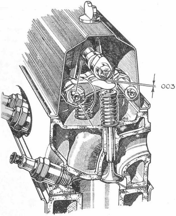

Re: Rocker problem
Here's the Minor rocker finger arrangement from the handbook, showing the arc within which the eccentric must be positioned in order to maintain oil to the finger.
