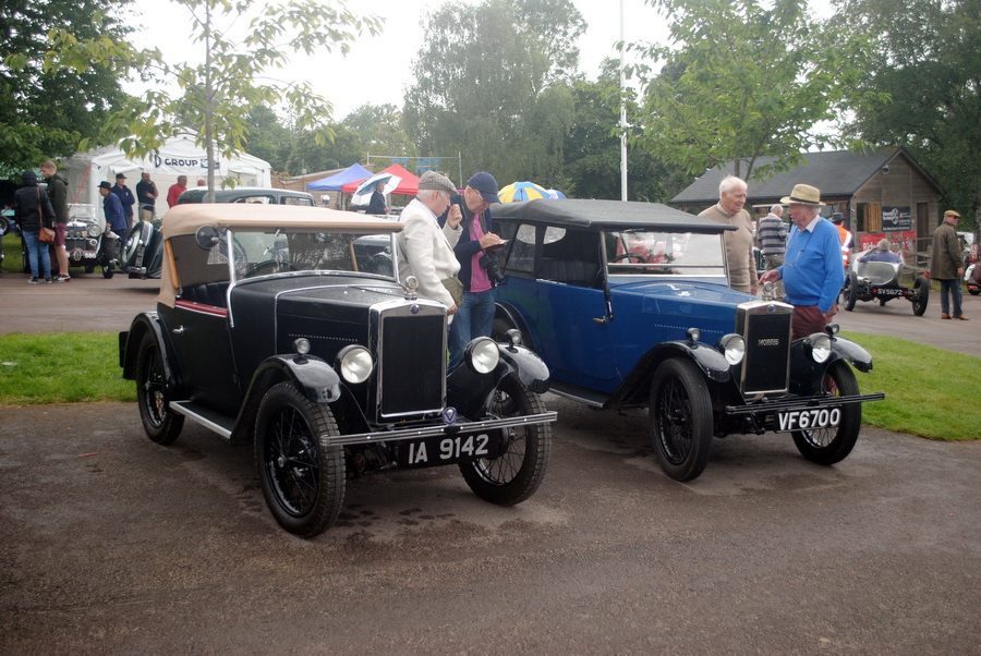

A quick note to record that Mike Houston sold IA 9142 in 2014, which accounts for the abrupt halt to this thread. The car was sold to new member Alastair Bond who brought the completed car along to our Summer Rally at Prescott in July, seen here with my old tourer which is now owned by Peter Stubberfield. Alastair is also a member of the VSCC and is now active in the Light Car Section with this very fine and beautifully restored Minor.

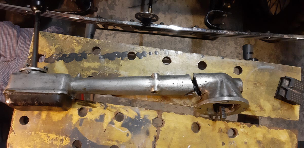

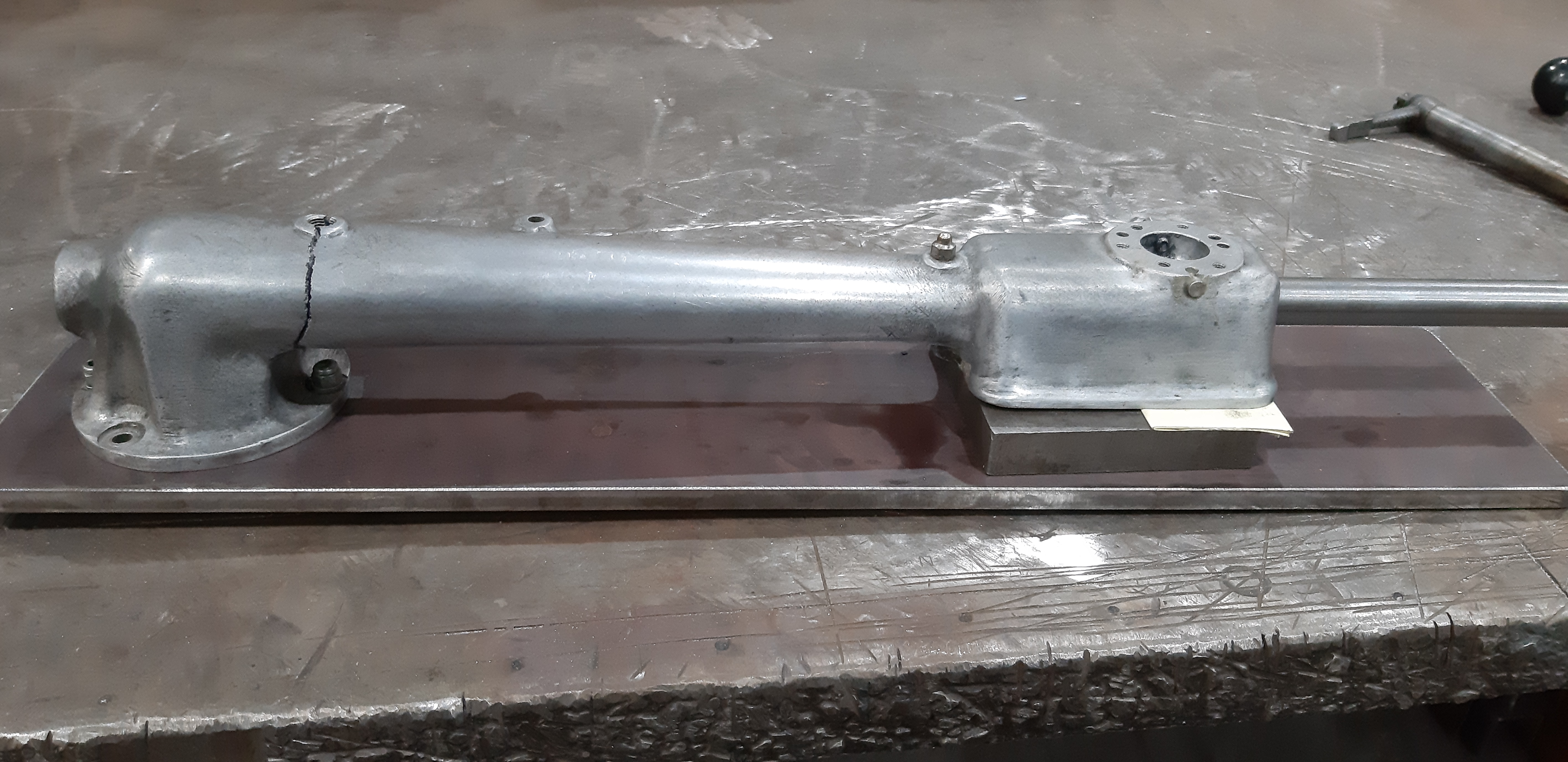

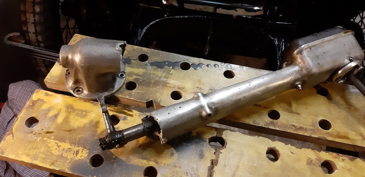

I've had a bit of a calamity with IA. Whilst the gearbox was removed from the car and sitting on my bench a poltergeist pushed it onto the floor resulting in a snapped remote gear selector casting. I believe it's a Wolseley item? Does anyone have a spare casting they would want to part with? I am attempting a repair, and have been busy making a jig/fixture to try and keep alignment when Tig welding (see top two photos).
The forward portion of the casting is attached to a 10 mm steel plate and the selector rod has been substituted with a bright mild steel bar with a good fit into the bearings. A machined aluminium bushing on the end of the steel bar is pushed into the casting end to provide alignment. The rear end is then packed up and shimmed (does folded paper count?).
Re: IA 9142
Oh, those are horrible pictures, Alistair. I will put out a plea in the April Newsletter for a replacement, if you have no success with welding.
