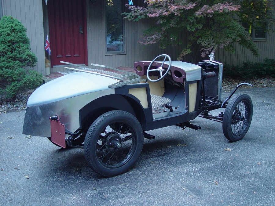

They were all fabric but had quite a bit of steel underneath. The scuttle top and tail sides were steel, and the rear deck was perforated steel. In this photo, it looks like shiny/polished fabric to me. (Keep the great photos coming, Mike! Any chance of bring it to Prescott? I'd love to look it over.)
Interesting that the later M's were steel, but that was well after the end of Minor production.
Here's a pic of the Bed-Pan showing the correct paneling prior to covering - except I did the tail and scuttle in ali instead of steel. Ronald, you may recognise the seat spring units - your father's handiwork! Mike, if you would like a copy of my Semi-sports CD, just let me know.

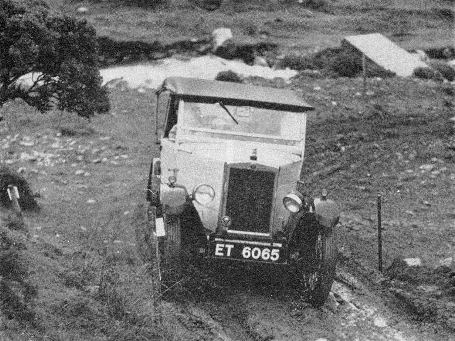

James,
Jim Peacop is Alex Peacop's father. Jim has owned a gray 1930 tourer for decades - ET 6065 - used to campaign it regularly in the VSCC in the Rosemary Burke days. In more recent years, ET has suffered - son Alex robbed it of its engine for his hot M project. Jim also has the McEvoy of course. He runs the Middlewich Motor Museum. Meanwhile ET languishes tired and engineless in his museum - I made an offer for it a while back, but was unsuccessful. As for the McEvoy, there is debate over whether it was originally a Mac or a Jensen.
Here's Jim in ET on Lanthwaite Green on a VSCC Lakeland back in the seventies when I first started visiting trials:
