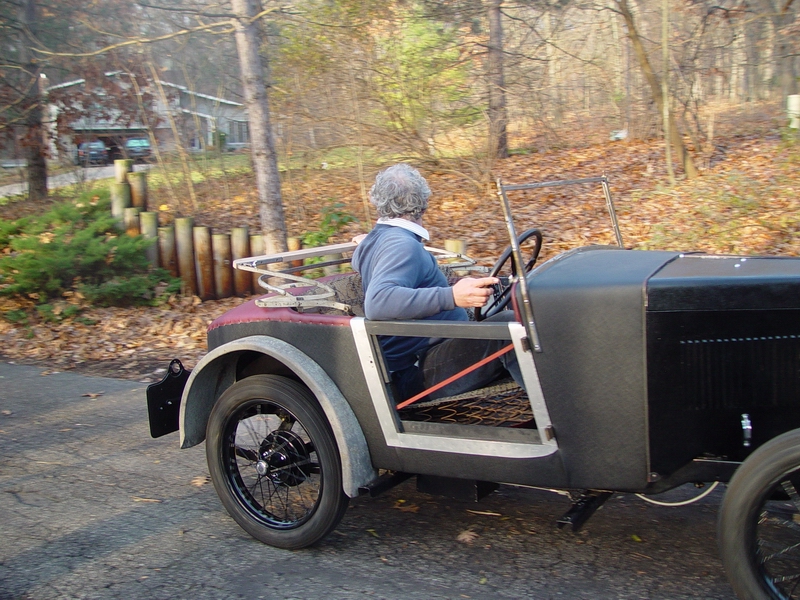

Here's the Bed-Pan showing the ali (originally steel) panels:

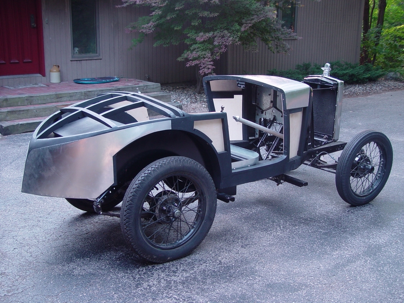

Latest picture. Just need 2 doors ! MFI ?

The doors are where it really gets serious! The issue, apart from the obvious is that you have to leave enough gap to contain all the fabric and ali strips that end up going on when you cover them. The front, back and lower edges of the doors have metal strips (was originally steel, I used ali) tacked on which cover the gap when closed - they stick out about half an inch. The fabric goes over these, but then you have the problem that in the shut faces, the fabric is concave as it doubles over the metal and then folds to cover the door shut face, if you see what I mean. The trick I used was to add another ali strip down the shut faces and cover this with fabric, doubling it over the strip, then taking it behind where the interior trim panel is, and then all the ali is cover, and the main door covering fabric cannot pull away from the shut face. So the net result is three layers of fabric and a thickness of ali to leave a gap for. But then you also have a strip if fabric and an ali strip on the body, so that is five fabric thicknesses and two ali thickness, plus then you need about a quarter inch of air gap, so the actual gap in the bare ash frame is considerable. This is particularly important across the bottom of the door because if the door sags even a tiny bit in the future, then it will foul on the threshold. The original Semi-sports had a long ali threshold strip with Morris Motors stamped into it - like the fabric saloons had (Halbe, has your car still got these?). On the Bed-Pan, I used a plain strip of ali and then tacked the saloon-type German silver threshold plates over the ali, and this plus a small amount of space for the tack heads makes it even more important to end up with enough gap under the door.
So you do all this and calculate the width of the door cover strip overlaps to cover all this and the gap, and then you find the door won't open because the cover strip at the front edge of the door (actually three pieces fitted between the two hinges) fouls the fabric on the scuttle when it turns inwards as you open the door, so you have to make sure you mount the door out a bit from the rest of the frame to cope with this and also the fact that this cover strip and the fabric over it have to lay on top of the body frame when the door is closed.
To prevent any possibility of the doors sagging, I added a non-original diagonal steel strap from the top front to the bottom rear of each door - letting it into the frame so it didn't interfere with the trim panel.
As for the trim panels, with so much of a necessary gap between the ash frame members of the door and the body, you need to be a bit careful with the trim panels, making them very slightly oversize (after allowing for the thickness of the fabric turned over their edges), otherwise you end up with large and ugly gaps in the trim when the door is closed. Also, if your instrument board/cubby assembly is correct, you'll find you cannot close the doors if you don't make a small rectangular cut-out at the top front of the door trim panels to accommodate the lower/outer corners of the cubby face plywood. That means that when you do the door shut work I described above, you'd better make a neat job of folding and tacking it in place around the door in that top/front corner, because it will show where the cut-out is. Also, the ali cover strip above the top hinge on the front face of the door has to fold in over the radiused top rail member, and it also has to have a cut-out to accommodate the cubby board.
As I said, this is where it gets serious! :o
Here's a pic showing the driver's door as yet uncovered, showing the ali strip and diagonal steel strap:
