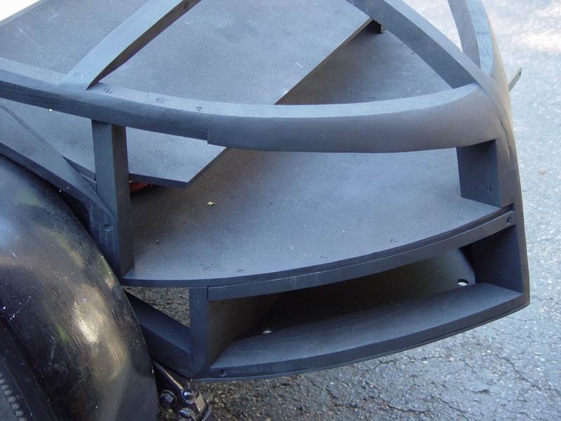

Ian Grace
Site Admin
Posts: 5223
Joined: Sun Nov 19, 2006 12:55 am
Location: USA
Re: Semi Sports Body.
Post by Ian Grace »
Tony,
Here is a closeup of the Bed-Pan. I was lucky enough to have the original timbers to copy, but even then it was a nightmare trying to get this rail spot on - took a few false starts. I don't blame you for cutting corners (if you will forgive the pun!), but there might be some forehead slapping awaiting when you come to try to skin the tail! :roll: :roll: :roll:
This photo highlights another tricky spot - it is at the rear end of the wing/wheel arch. You can see in this photo that because the inner edge of the wing is rounded, then there is a triangular shaped gap where the inner wing leaves the body. When you come to fabric the car, this looks ugly, and the wing piping is too thin to be any real help. I think I ended up stuffing the fabric in this area with extra wadding, but if I did another one, I would make a natty little ash fillet and fit it in there. I'm not entirely sure how Morris dealt with this, but suspect that there actually was a hole in this area.
