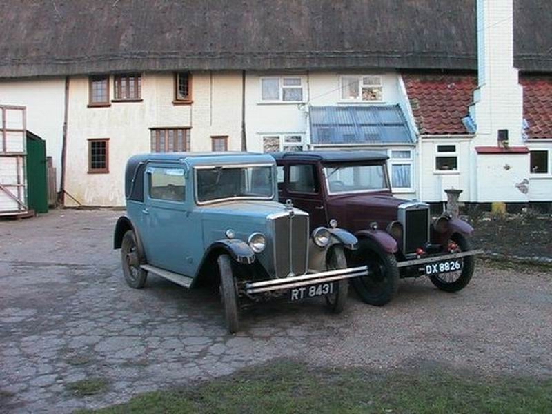

Yes, we know this car - chassis 36296. Here is a photo of it taken alongside Eric Mouser's saloon about five years ago. I look forward to seeing it recommissioned and back on the road again! If your no. 2 and 3 compressions are down - could the head gasket be blowing between the two cylinders? This is where they usually go. But if the engine is newly rebuilt, this is perhaps not likely - unless the head wasn't tightened down properly after initial running for a few hours.
Incidentally, your OHC angine and hydraulic brakes are absolutely correct - 9" finned Lockheed brakes were fitted to the 1932 season OHC LWB Minors, but the LWB chassis reverted to cables (and SV engine) for the '33 season. 8' hydraulic brakes were then re-introduced for the 1934 season SWB SV Minors. The '32 Minor you have was the first Morris to receive hydraulic brakes - and those 9" brakes are the best on any Minor.
Keep us posted on progress!

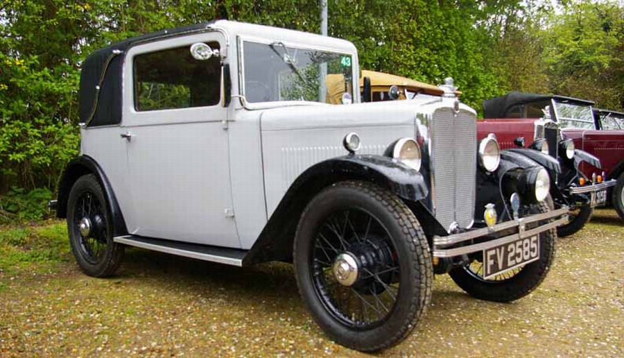

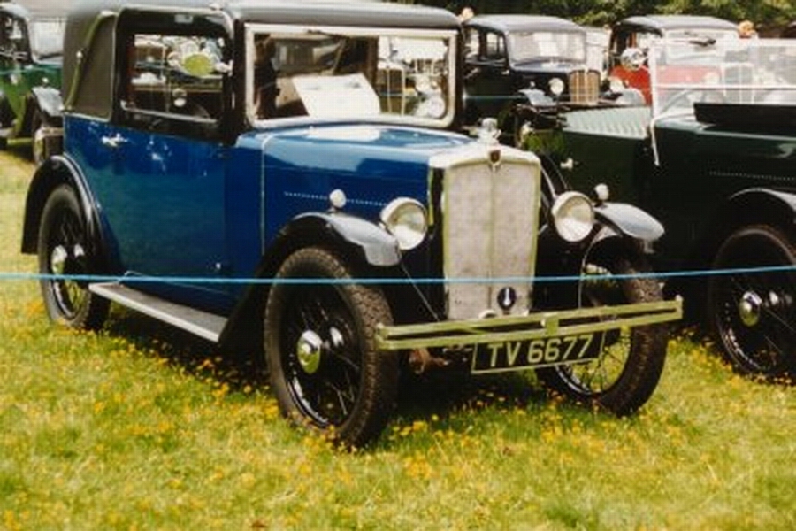

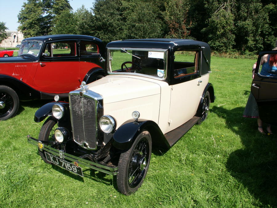

Here are the other three Sports Coupes known to the Register. Anyone know of any more survivors?

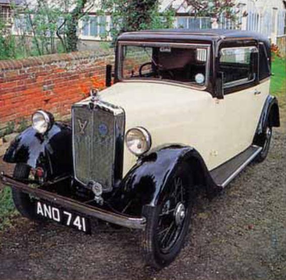

For comparison, here's the SV Special Coupe of the 1933 season - the ex--Bev Hicks car, last heard of with Tony Relf in Essex and subject of an article in The Automobile of November 1991:
