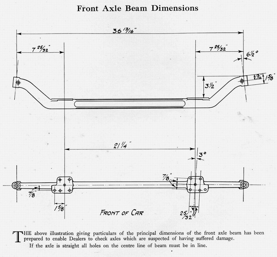

I found the front axle on the Bed-Pan to be bent and it was straightened by a commercial vehicle chassis repair shop in Grand Rapids, Michigan. Perhaps a bit too far to send yours, but you may find a similar establishment near to you.
If you don't have the Morris Motors service sheet that covers front axle straightening, I can send you a copy - you will need it for the dimensions.
Re: front axle
Here you go:
