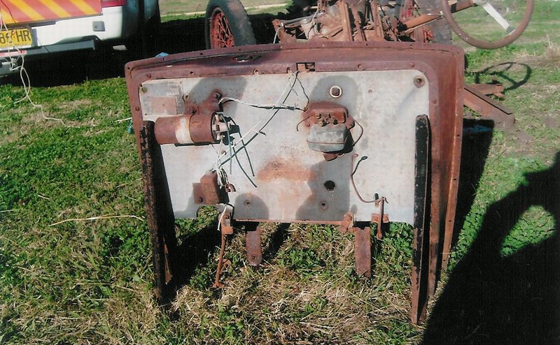

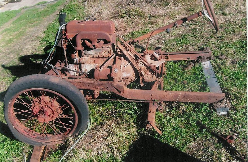

This report just in from Ewan Lambess in Lochinvar, Australia
Y329 is now stripped to its bear chassis or should that be two chassis ( front & rear). As usual all the shackle hangers are in need of repair,shackle pins totally worn half way thru,all springs need major work with two main leaves broken. I can see why they modified the diff housing as the axle tube has broken at some stage & has been brazed back together.The axle shaft has been welded back together, thinking maybe a longer shaft has been cut down as it is a really neat weld about 3 inches in from the hub. The rear wheel bearing hubs have much larger wheel studs as it would appear the original studs must have broken off.
Looks like I have my work cut out for me on this one.

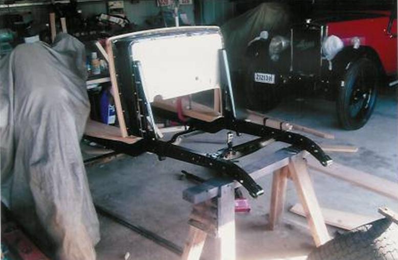

Latest image of Y329 from Ewan just received, showing tremendous progress. Here we see Y516 watching Y329 getting rebuilt as it may have done 80 years ago in Melbourne motor body works. The frame is complete, just one more door to be made then it's time to skin it.

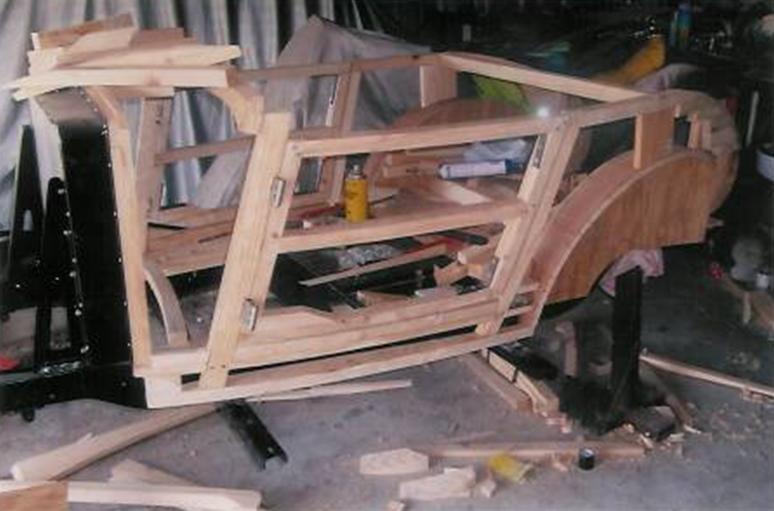

More progress by Ewan - ash frame complete and ready to skin.

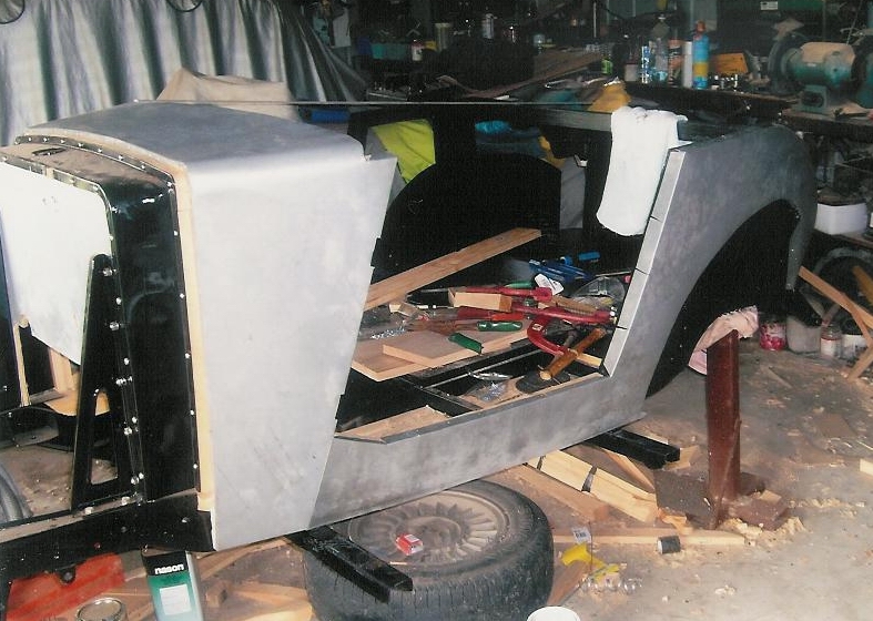

Latest progress - paneling under way on the nearside. Ewan reports that it has just been so hot in NSW that it is impossible to work in 40 deg heat.
