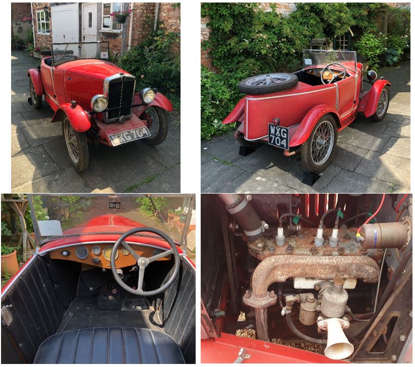

Following the publication of the most recent newsletter, it seems the cat is out of the bag!
I have acquired the ex-Mark Lynch car, SV14930.
Plans are well and truly afoot, and I will update you shortly. In the meantime, here is a quick snap from the retrieval mission - a 12-hour round trip on the hottest day of the year, with my trusty Skoda and my brother Bruce riding shotgun.
More to follow.
More to follow.

Time for an overdue update on the special, now that I have made it through both the argh-what-have-I-done phase and the sitting-looking-at-it phase.
I have been working on it on-and-off over the past 12 months, with lengthy pauses to enjoy rallies and driving tests in the SV 2 seater and also to moonlight as a trials bouncer in a friend’s Austin 7 (I know, I know…).
So, what have I got?
An SV Minor that was exported as a rolling chassis to Australia when new. I will delve into the history in a future post, but the car was repatriated by Mark Lynch in 2015, wearing a very eccentric trials body and knobbly tyres. I bought it from Mark last summer.
The good bits:
- The chassis is rust-free and solid
- The axles are in good nick
- The wood is all sound
- The bonnet is alli, and weighs less than a feather
The not-so-good-bits:
- The engine is seized
- The gearbox is about to detonate
- Mice had moved in and caused havoc
- It doesn’t look very vintage!
Here are a few photos as bought. It looks ok from afar, but the deep shagpile carpet hides a multitude of rodent-related sins. Enjoy the crusty engine, complete with absurd intake trumpet!

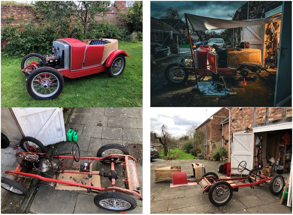

So, what are the plans?
The dream has always been to go hillclimbing. My SV 2-seater is far too original to molest in the name of motorsport, so here is the blank canvas that will (one day, I hope) get me on the start line. Let’s see how much speed we can get out of a sidevalve!
Plans are still evolving, but I would like to go for something that could have left the works in period. A sort of skunkworks special, if you like, put together by the boys at the Morris works to see how quickly they could get a Minor to go.
Purists, avert thine eyes! Although I will try very hard to make it as “period” as possible, and anyway, that’s why I started off with a car that had already been messed about with.
One thing it definitely won’t be, is an M-Type clone. As much as I love them (the M-Type is my dream car), there are plenty about, and I think it should remain a Minor.
This is very much a budget backyard build, but stay tuned, we’ll see where this goes.
The name? Well, the working title is LVS (for Light Van Special, or Light Van Sports) as this mongrel of a car seems to comprise a number of bits from a Minor van.
Here some photos from phase 1.
