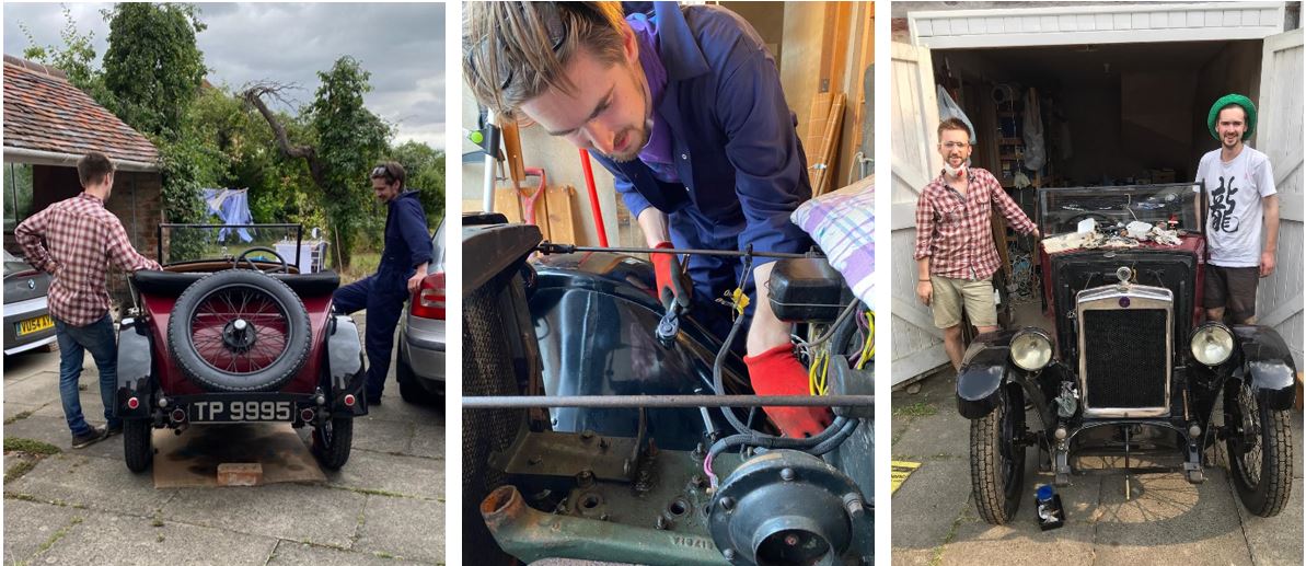

Right, time for a long overdue update.
As I had the pleasure of meeting many of you out and about last summer, you will know that TP9995 is back in circulation, and that I am delighted with it. So, what happened?
After the car failed miserably to get me to PWP ’22, brother Frank and I decided that a valve had stuck (we’re not mechanics) and whipped the head off. When I say “whipped”, I mean spent 3 weeks’ worth of evenings pulling, pushing, grunting and swearing before it finally relented and came free.
The innards were well clogged with carbon, the valves felt lethargic in their operation, and the water jacket was full of brown gunge. We spent yet more evenings cleaning, polishing and prodding various parts of the top end, and taught ourselves (using a combination of the original handbook and the Internet) to lap in the valves and set the ignition timing. Once we had decided it looked presentable, we threw it back together with a new head gasket. We filled the rad, and watched as the water poured out from around our new head gasket!
An anguished call to Ian Harris established that we simply hadn’t done everything up tightly enough, and the following weekend, we were able to try a start-up. It started, but barely ran, and did so like a bag of nails.
By this time, the 2022 driving season was well and truly over, and the car would fester until the following Spring…
