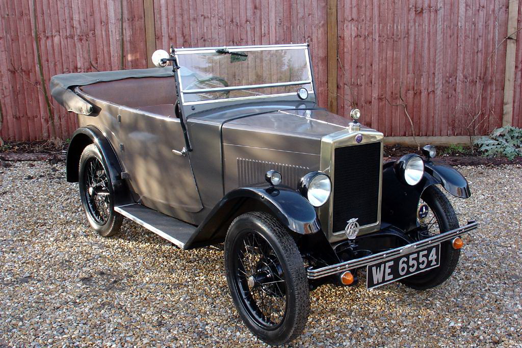

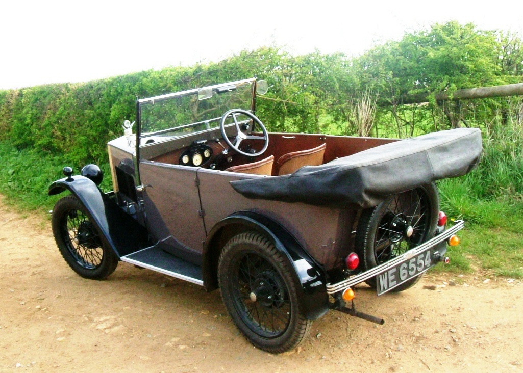

As you can see from the photos below, the car is in first class condition and appears to be the only surviving 1929 Minor tourer in brown. Only two colours were offered - blue or brown.

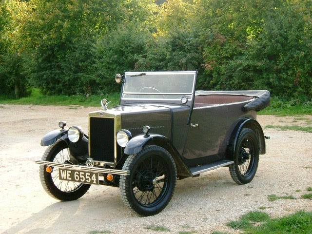

Taken recently in the Cotswolds, this photo really shows off the Minor tourer's handsome lines.

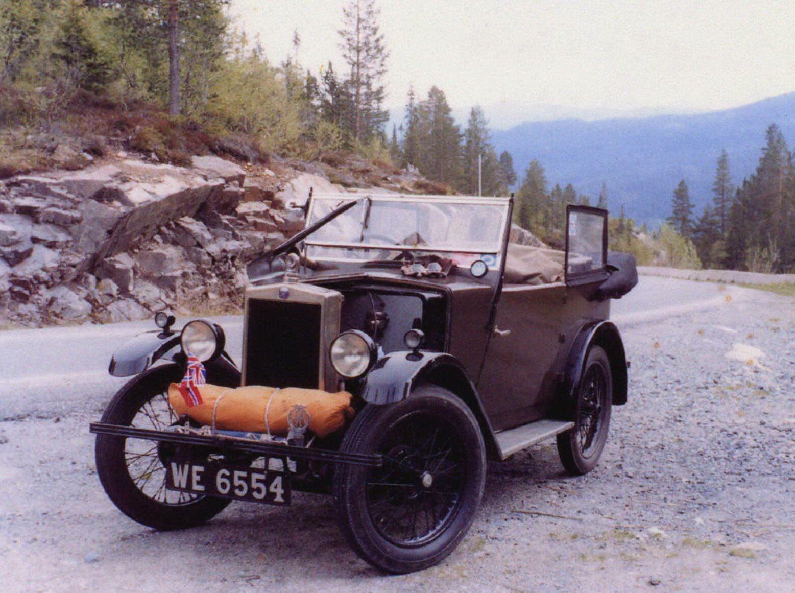

After John Peckham completed the restoration of the car, he toured Norway in it. Here it is seen on the long long climb up to Rjukan. It has also toured Ireland.

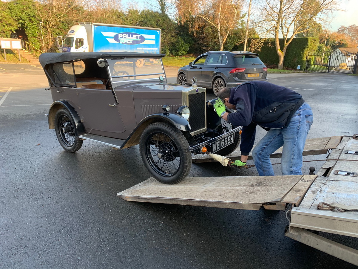

WE 6554 was delivered to Lawrence Bleasdale's Cowarne Brook Farm at Bromyard today. Geoff Colquitt gave her an emotional goodbye, sending her on her way to her new temporary digs, until our return to the UK. Very excited to be the owner of a really nice 1929 Minor tourer once again.

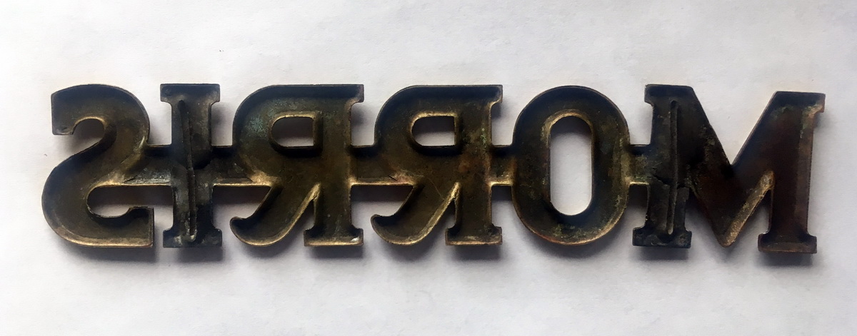

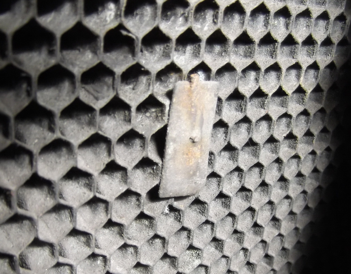

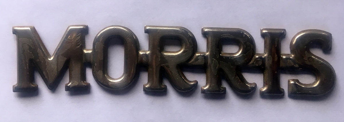

Today I received a MORRIS radiator script from Tom Bourne to replace the one that has been missing from the tourer for many moons. It was absent from the car when John Peckham restored it back in the seventies - see picture above, taken in 1979.
These radiator scripts were fitted to just the 1929 season Minors - presumably to distinguish the new small car from the ubiquitous Sevens that were on the road at the time. The script is attached with wires that are soldered onto the rear of the badge, which is a nickel-plated brass pressing.
As you can see, this script needs a little careful fettling as the M is slightly bent and scuffed. Once that is done, it will be nickel plated and have new wired soldered on. These wires were folded over a pair of one inch rectangular brass plates on the rear face of the honeycomb before being soldered to the plates.

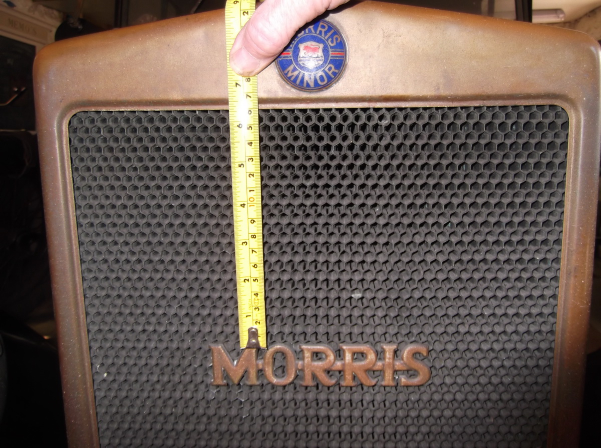

One important aspect of re-fitting is to make sure that the wires are spaced correctly to fit comfortably between the cells of the honeycomb. The spacing should be one inch exactly.
Finally, the script should be positioned correctly - slightly above half way down the core - as seen below, with 6.5" between the tops of the letters and the radiator shell.

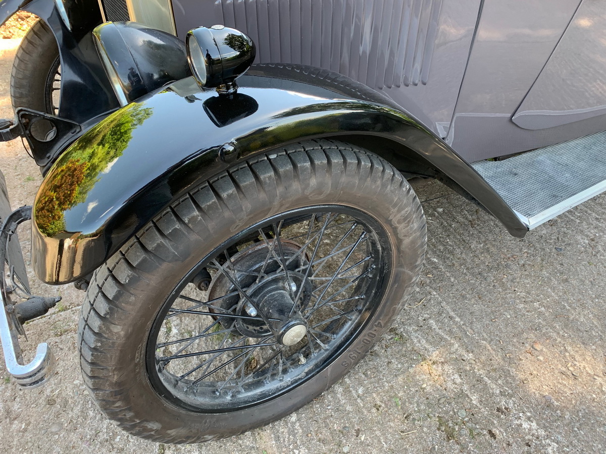

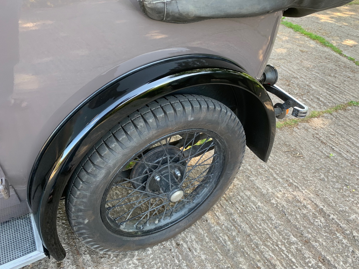

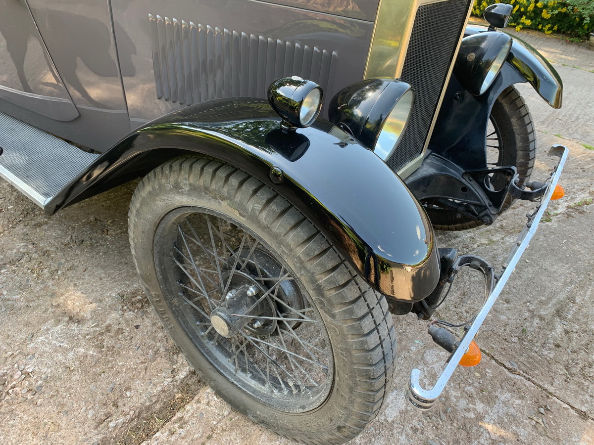

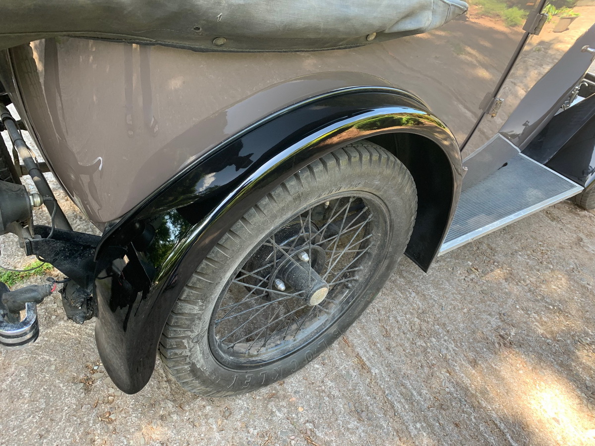

Courtesy of Lawrence Bleasdale, who is caring for the car at the moment, he's just had the wings repainted - and they look spectacular. It went in for one front wing to be repainted, but came out with all four done. Plus the sidelamps, by the looks of it. How does that happen?! All nice and shiny for Pre-War Prescott!

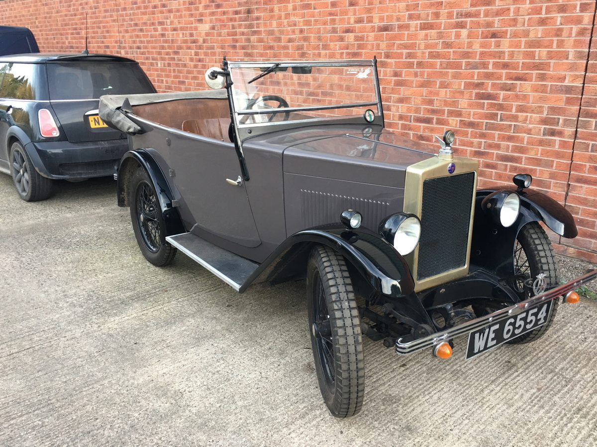

The photo below was taken on Saturday afternoon when I collected it.
