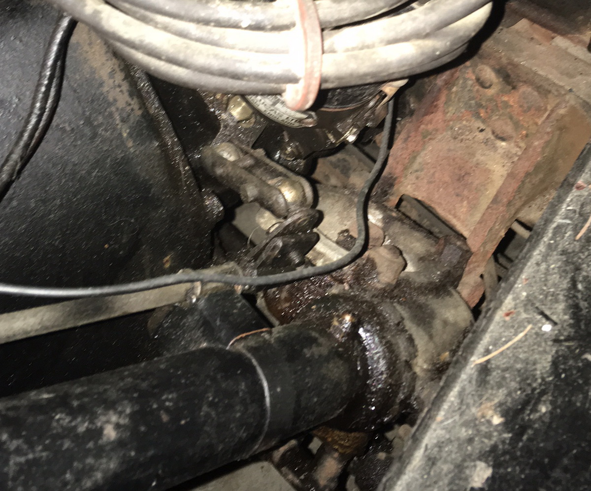

Thanks for the advice Ian. I tried that but still no joy. The rod fouls the head of the through bolt at the column clamp, and if I move the rod further down to clear this then at the link there is basically a circular motion that doesn't move the distributor much at all. Logic says that the ball-ended bracket on the end of the rod should be somewhere near vertical to get maximum travel. Also, my rod has a flat area where that bracket fits, suggesting that is supposed to align with the straight portion of the bracket. Is that the case or is it just coincidental wear of the rod?
Any chance of a close up pic of the bottom end detail, particularly the orientation of that little bracket and the rod support on the column?

Hi Barry,
Here's a photo of my fabric saloon that may help. I can take more if need be.
There is a flat at the lower end of the rod which serves to prevent the ball-ended bracket clamped to the rod from rotating.
The geometry of the whole arrangement isn't ideal from a mechanical point of view, but it does work.
Also visible in this photo is the lower steering wheel clamp, which should give you an idea of its orientation, which is the same for the top bracket.
