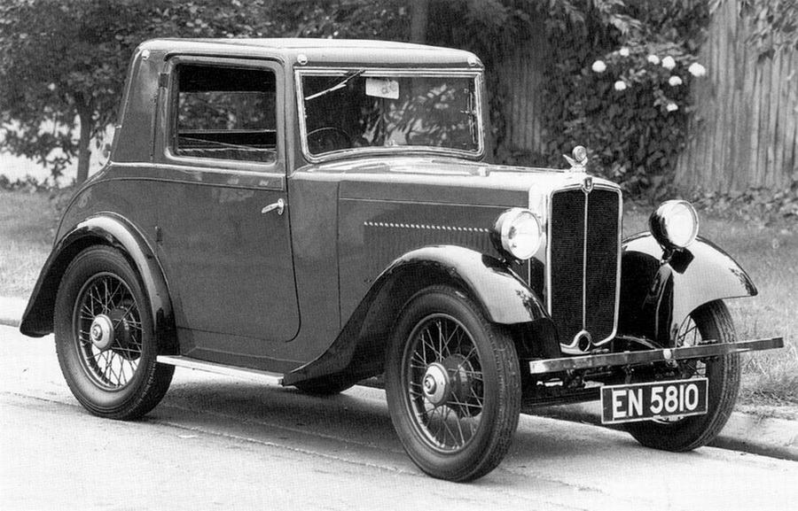

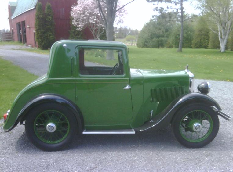

Here's some photos of this quirky little car - the black and white photo was taken some time prior to its 1975 export. The car has never been restored.

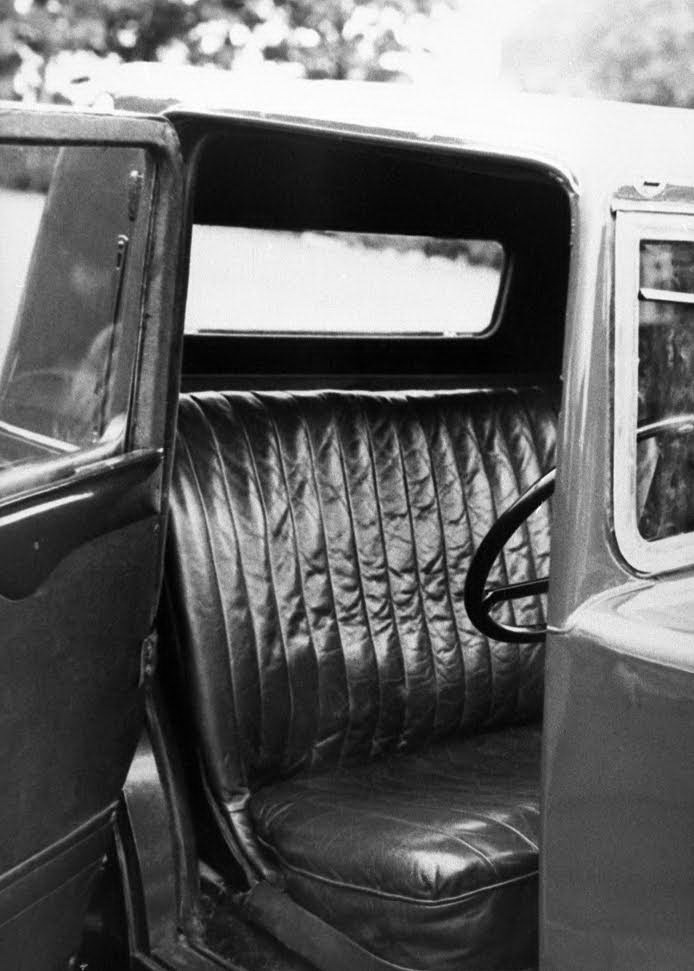

Thanks Martin. Here's a photo of the interior - high spec. with leather bench seat.

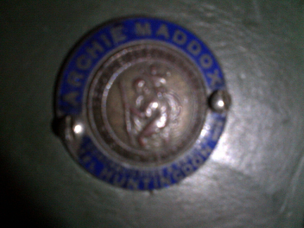

It isn't the best photo, but here is the Archie Maddox, Huntingdon plaque on the leather-covered instrument board:

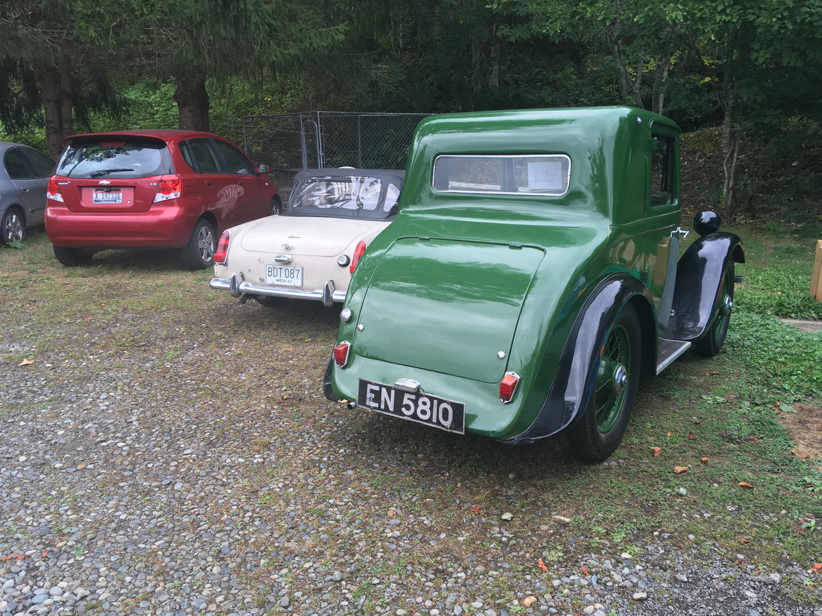

The Maddox arrived in Seattle from Ontario yesterday!
Many more pics and info shortly.

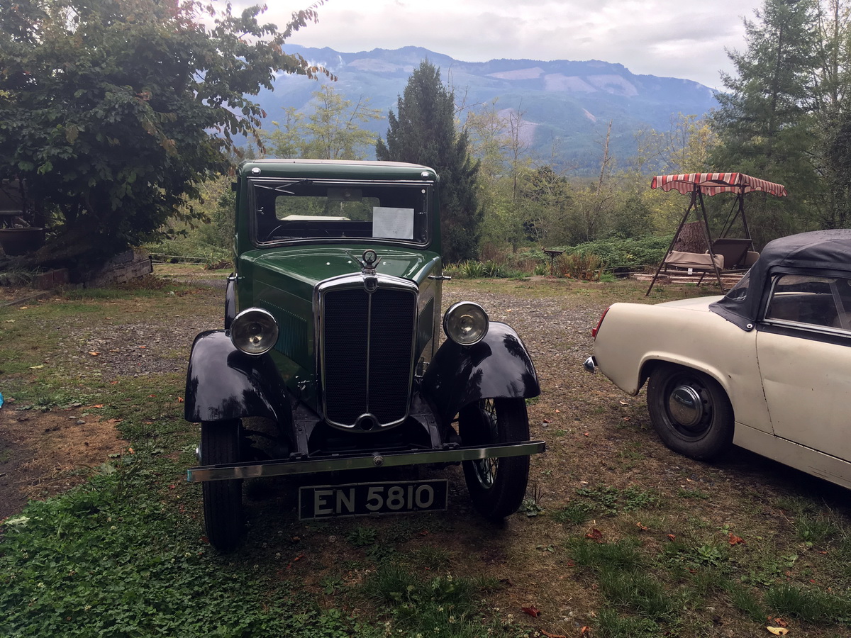

An afternoon of some frustration and some success. The car is not running well, having been laid up for so long. There is a steepish hill about 1/4 mile up from our house, and there was no way she was going to take it - even in second. There was just no power past about half throttle, so it wouldn't rev to produce any hillclimbing torque.
A frustrating couple of hours was spent fiddling with the timing and mixture, but everything I tried made things worse. To complicate matters, the American fuel pump had an adjustment from 1 to 5 on it. Perhaps fuel pressure? I had the plugs out, cleaned them, opened up the gaps which seemed very small. This made things worse, so I closed the gaps again.
Then I found a new set of Lodge C3's which I had laid down for the McEvoy. Fitting these improved things a lot, but there was still something seriously amiss. I then had all of the HT cables out of the distributor cap and cleaned off their ends. And finally I took the cable out of the coil, to find that there was a heavily corroded wire stuffed into the end of the coil with no nut! It was only being held against the contact by a rubber gaiter on the cable. I don't have the correct long nut but I re-terminated the cable and stuffed it back in tightly and the result was amazing! The car now takes the hill easily in third and I have had it a couple of miles up the hill and back. I won't be driving it much further for a while until I have the brakes rebuilt - currently there are virtually none - perhaps 10% of what they should be.
There is no charging, but the semaphore indicators work and there are brake lights. The oil pressure gauge is not reading at all, but I can hear that there is oil pressure. The fuel gauge reads zero. So a complete re-wire is in order, plus some instrument replacements.
Plenty do do over the autumn and winter months, but this is a car that will respond very well to a thorough running sort out.
Finally, I removed the front bumper assembly which was covering the front dumbiron and chassis number. Removal uncovered the correct chassis number, so the paperwork can now be presented to recover the original number EN 6810, the car never having been registered in the USA or Canada.
Here's a shot of her taken this morning on our property with the Cascades behind.
