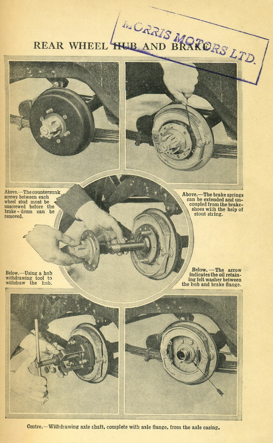

Martin,
The felt seal comes as a simple ring of felt - no metal parts.
The cupped steel housing it sits in has a piece of the edge cut and bent flat - so it protrudes beyond the outer radius of the housing. It is this tab that reaches out to the bolt heads.
Here's a page from the Minor Manual. Note in the photo at lower right that the backplate bolt heads are very close to the outer radius of the felt seal in its housing (arrowed).
Note also the method of easily removing and replacing the brake shoes by passing a length of string (I use wire) through the hook at the end of the brake shoe return springs.)

Thanks for these pictures Ian. There is certainly no retaining washer of this sort in the hub at the moment and from the pictures, the felt washer in its housing seems to be a much larger diameter than the internal diameter of the bearing housing, which means that it will not come into contact with the 66thou washer deep within the recess of the bearing housing.
I could be wrong, but wheras you have just had breakfast, here it is midnight so I'll have another look at my hubs in the morning and get this worked out.
