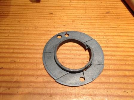

Its like a flat disc of metal a but like a spacer which I think sits on top of the base underneath the dashpot?? I think its part of this carb otherwise it could be just a random bit thats been put with it. I will take a picture of it and post it tomorrow.

OK I have found the piece that is broken. It seems its the piece that centres the piston in the base of the carb.

I have examined my carburettor , and the spares , and there is no part like the one you have shown.
Contact me on my email address , anthony.gamble@btconnect.com , and we'll see what we can do to sort you out.
