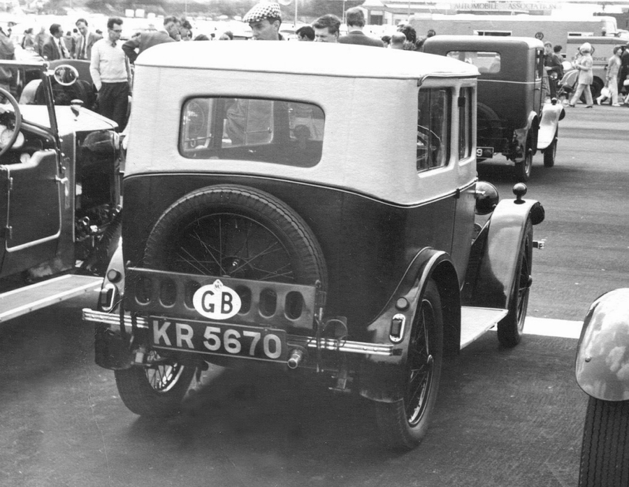

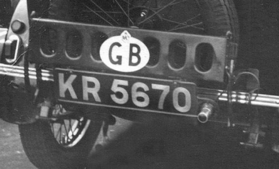

Re: USJ - 1795 (M22335) 1930 Minor Tourer (India)
Understood - interesting.
Here is the original rear number plate and lamp on KR 5670. Ignore the luggage grid which was a later fitment.
You can see the Lucas TF201 on the 'ear' on the right side of the original pressed steel number plate. These are available - albeit in cast aluminium. Does anyone know of a supplier of pressed steel ones to this pattern?
As you can see, KR has had dual lamps and reflectors added to the wings - pity! (And it is worth also mentioning that the original location for the number plate was suspended under the rear chassis tie rod, but it has been relocated on KR to the luggage grid which would have obscured it in its original location.)

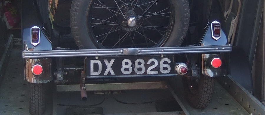

Here's the rear bumper on Eric Mouser's saloon - clearly showing the correct bumper. And I see you have the correct bumper on the front of your car.
Correction to my earlier post - the number plate hangs from the bumper on the OHC models, as can be seen here, and from the chassis tie-rod on the SV models which generally didn't have bumpers.
