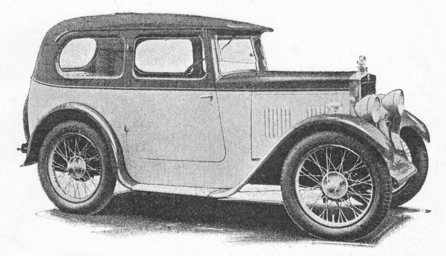

And here is the only known image of the original Swallow-bodied Minor:

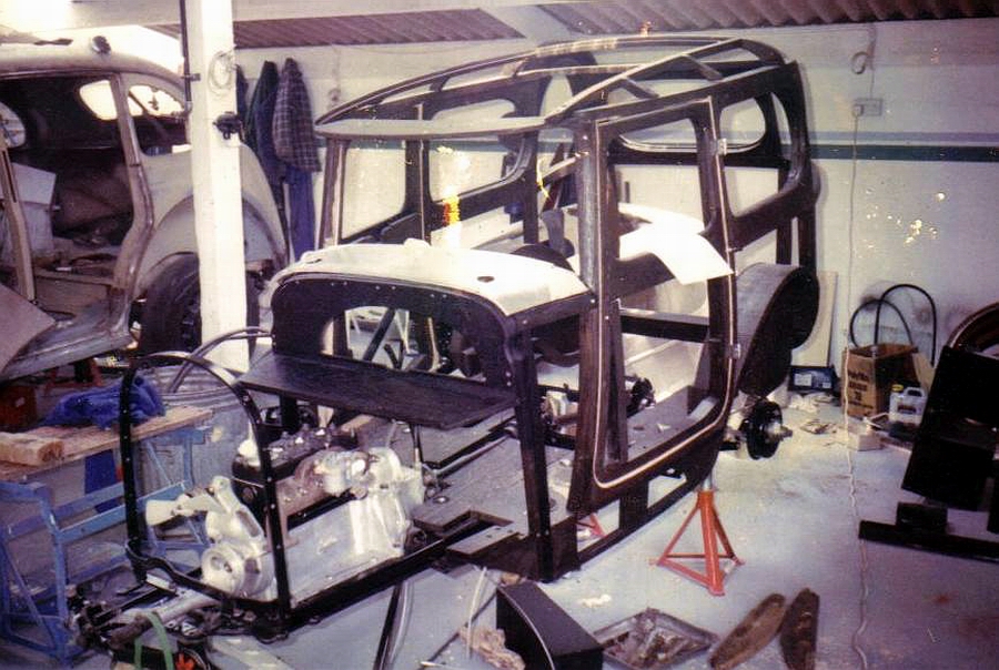

Here's the Swallow ash frame. No more complicated than a standard Minor saloon frame.

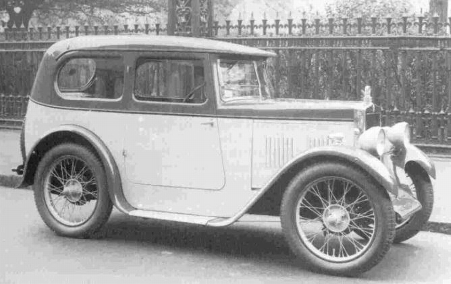

Here's the Autocar street photo that the retouched image at the top of this thread came from.
This car was exhibited as an ‘experiment’ at Henlys, Euston Road in the autumn of 1930. This photograph appeared in the Autocar of 21st November 1930. But note the flat lower edge of the bonnet just visible behind the front wing, indicating a 1929 season chassis was used. There was an article about this car in VMR Magazine M 109.
