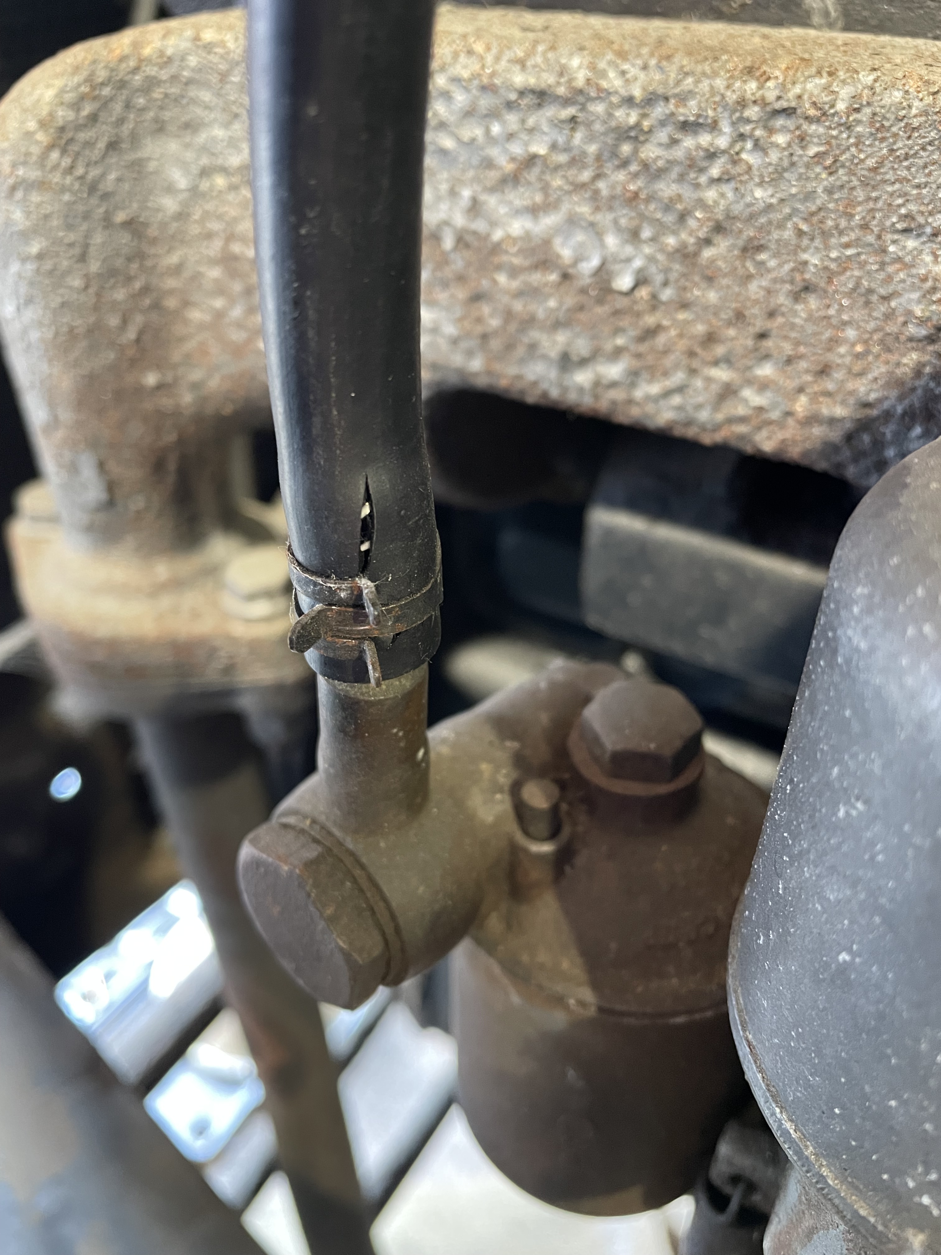

I'm pleased to have spotted this perished fuel hose now rather than later. I suspect I've had more flexible copper pipe!
Now replaced with some 6mm ID fuel hose that I had to-hand.

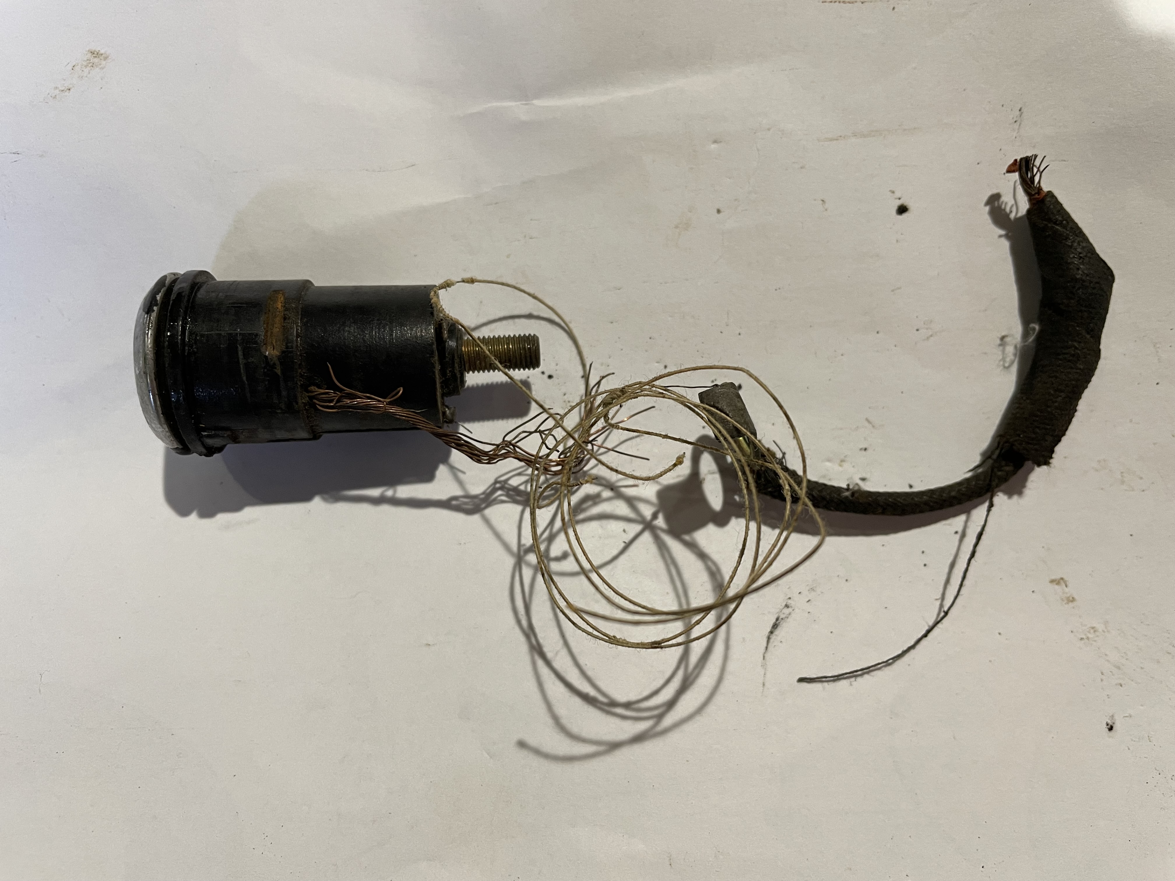

Whilst working on a complete refresh of the dash, it's clear the Ignition Warning Lamp is also a little past its best.
Ignition warning lamp.jpeg (3.11 MiB) Viewed 2090 times

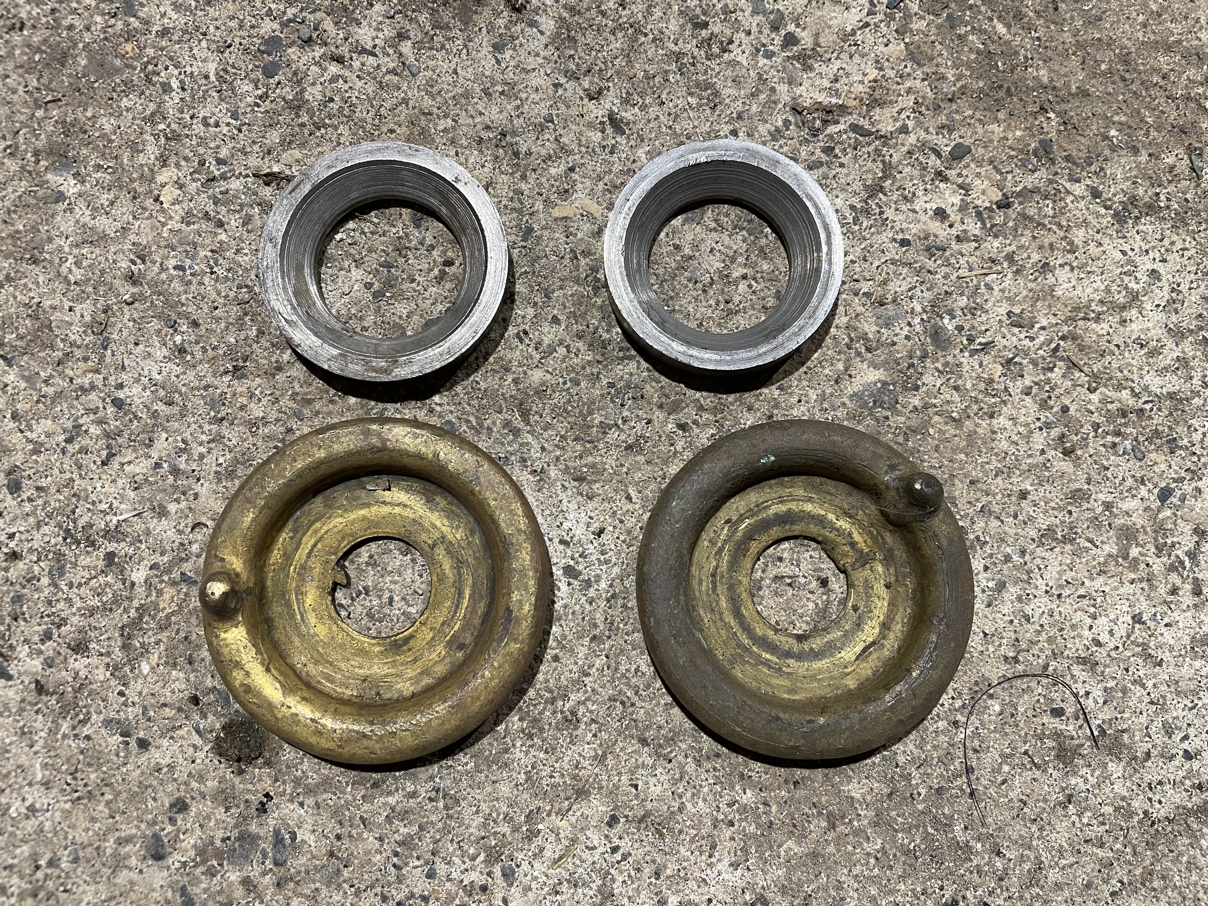

Where do these go?!
Unknown axle parts.jpeg (6.79 MiB) Viewed 2089 times
Posts: 5222
Re: 1933 Maddox Fixed head Coupe EN 5810
Paul, these are for the front hubs. The chamfered steel rings go on the stub axles first, then the hub, then the brass oiler plate and finally the nut. If you fit sealed front wheel bearings (set of four), you don't really need the brass oiler plates.
Great progress!

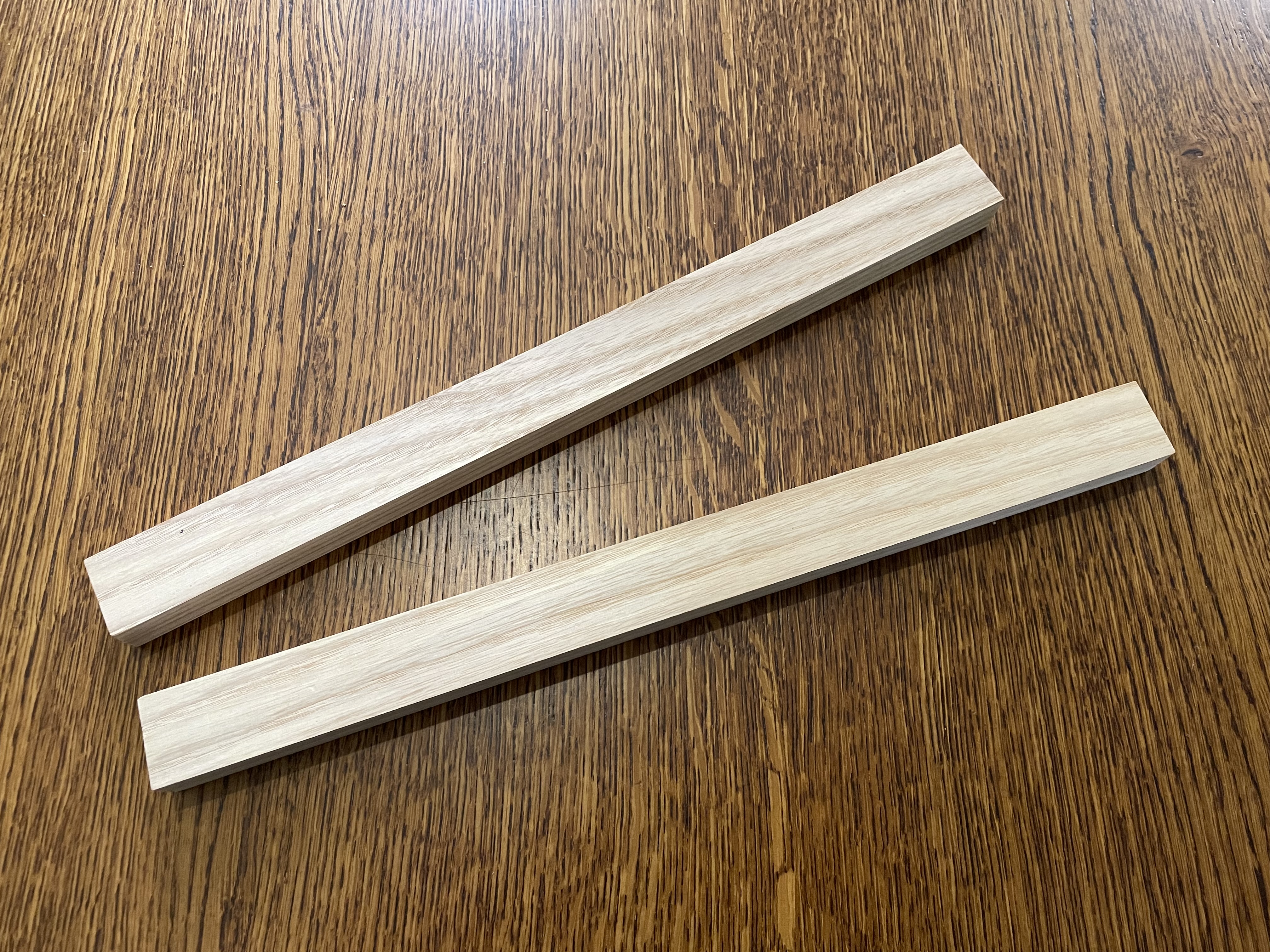

Sourced two Ash battens to fit on the floor support brackets where the new floor is to be fitted. These were sold as off-cuts on E-Bay by a very helpful seller that cut them down to the required finished dimensions, just leaving me to mitre the ends to-length.
Ash battens for front floor mount.jpeg (4.24 MiB) Viewed 1725 times

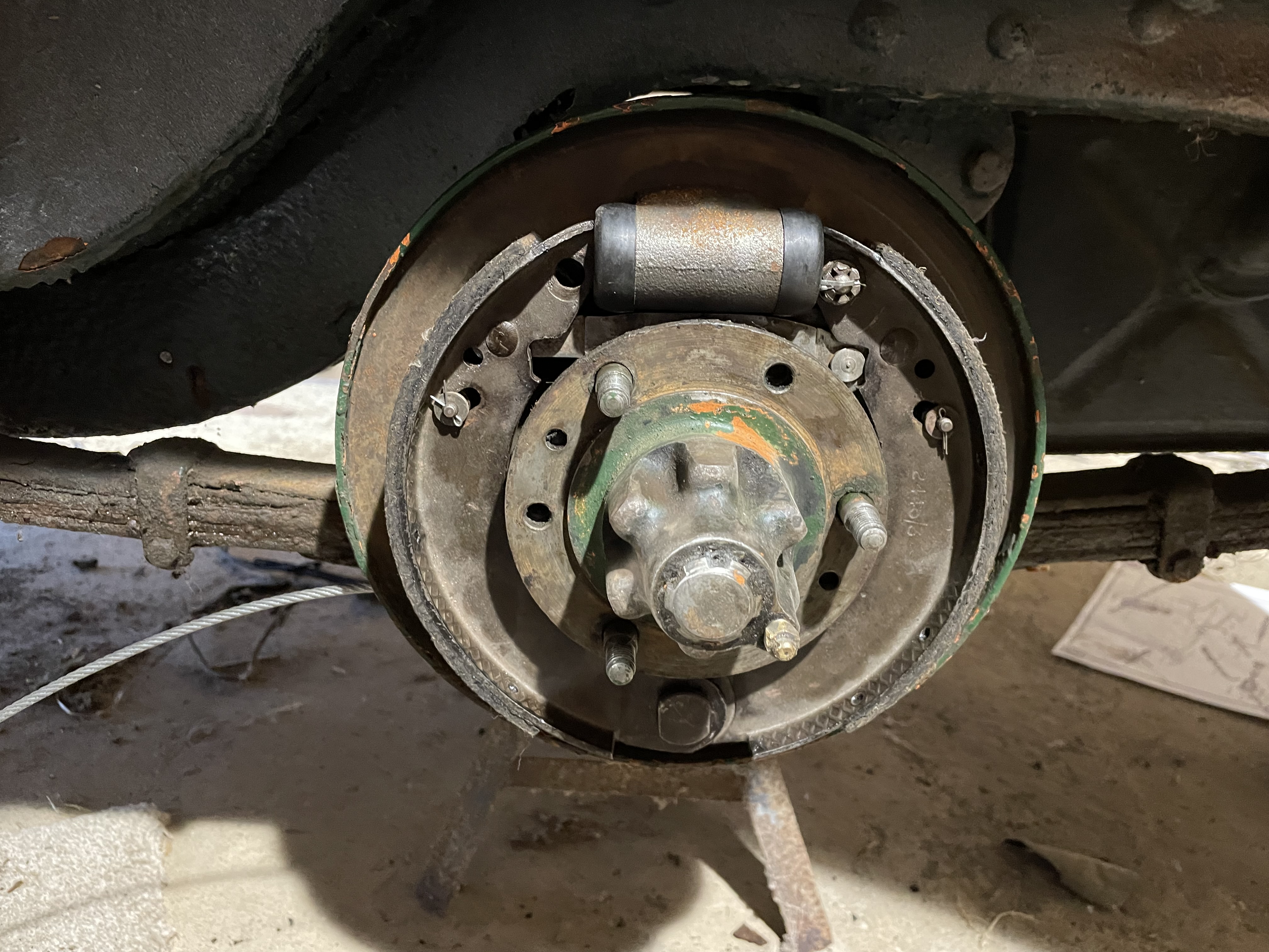

NSR brake finally assembled, though I had to remove the recently fitted slave cylinder in order to fit the shoes - does anybody know if this is correct, or did I miss a trick?
NSR brake assembled.jpeg (2.85 MiB) Viewed 1724 times
Posts: 5222
That looks all good, Paul. Well done for solving the jigsaw puzzle!
