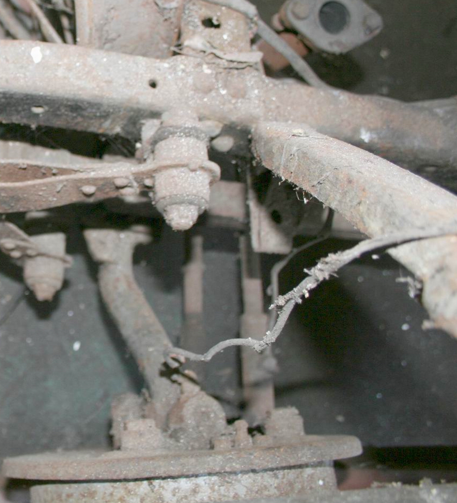

I require a little more brain power for this task - I was trying to fix it to the Mud Guard holes! strange how the four holes actually line up with those in the bracket, Mr Morris must be deliberately trying to confuse me!
Front Cable Run 2.jpg (64.16 KiB) Viewed 5155 times
There are two holes to the right of this grouping that would provide the 45 degree cable run, if the bracket is inverted such that the pulley 'hangs' below the angle of the bracket? If I assemble it in this fashion the pulley on the trunion is 'low' resulting in a poor cable run; or is this because there is no load on the suspension? as the chassis is loaded the two pulleys might line up?
As the suspension rises and falls does it not result in the brakes being applied?

I'm trawling through the archives looking for pics that might help. Here's a period one. It shows the orientation of the chassis bracket, plus the approximate location on the chassis. Looking at this, it appears that you have the bracket in the correct location?
Comparing this image with the drawing in my previous post - which shows the late OHC arrangement, it certainly looks like the chassis bracket on the SV car is mounted further forward than on the OHC car.
Re: JF 4238 1933 Minor Saloon
Here;s another one. It's a dreadfully poor pic of my McEvoy (also 1933, so should be identical to your car), but it does show that brake cable bracket and the front wing stay are co-located with the same bolts.
