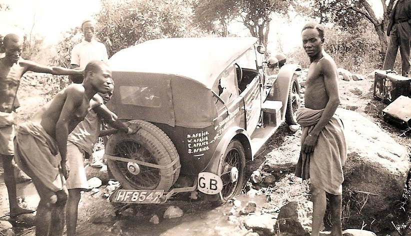

Toby,
I was just launching the May Newsletter with that super pic of the Gilg '33 tourer being hauled out of the Chimala River when I noticed that the rear of the hood has two vertical rows of poppers and looks like it can be opened and rolled up. I've never seen this feature on an open Minor before. The OHC tourer hoods certainly weren't made this way. (What about the SV 2-seaters?) It's not a mod. for the African heat, as we know that the only mod. done by Morris was to fit a lower ratio CWP.
Mind you, that rear sidescreen looks a bit second-hand. :o
