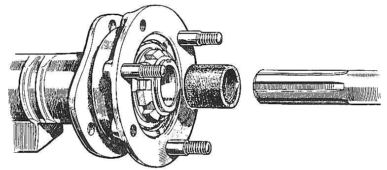

This might help - taken from the service sheets in the Members' Area:
The ring nut holds the hub tight against the step on the axle sleeve. Behind the bearing, and inside the hub is the felt seal and steel washer. Depending on how tight the bearing is pressed into the hub will determine the position of the hub, and therefore the brake drum with respect to the backplate. If the bearing is not in far enough, the brake drum will not be fully seated in the back if the bearing is pressed in too far, then the felt seal will be squashed too tightly and act as a brake. (A similar situation applies for the front hub felt seals.)
This drawing also shows the cork seal mod. There should be no other seals present in a standard set-up.
