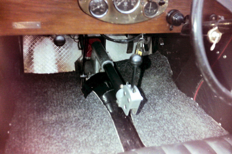

The top 2 images from David show a D-type 3-speed remote.
I have one on my M - works a treat

This just in from Tony Margel:
"The attachment is my D-type remote – don’t seem to have a better one at the moment. Currently the top is being re-built as it is crumbling away at the gear lever end! Also in the pic – the floor mats are £2 bath mats cut to shape – this is a Yorkshire car after all and the foot board is ex Bradford Corporation bus!
