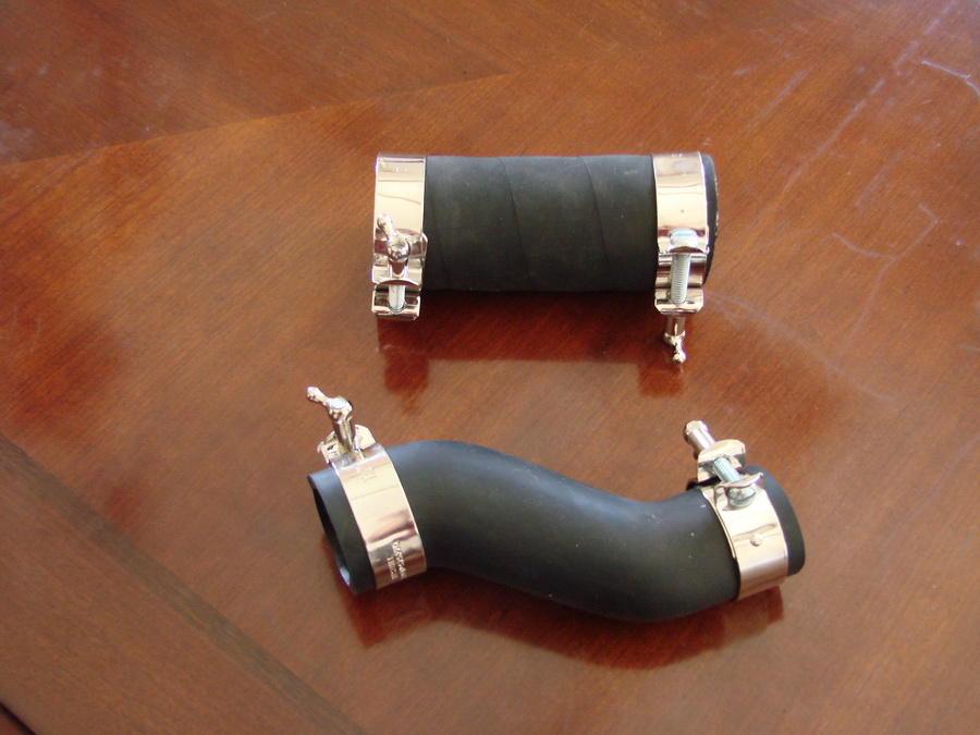

The only thing i still need is some radiator cord........and some original hose clamps. Are they Enots or Nesthill clips?

Looking good Halbe. Nestills are what you need.
Re: VG2007
Halbe,
The radiator hoses and Nesthills for my fabric saloon arrived this week. Sports and Vintage are supplying these chromed and with the loose bit riveted on which is quite convenient. Planning to fit them this afternoon.
