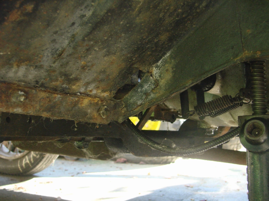

Re: KR 5670
While I was under the car at the weekend, I came across this tiny but very telling mod. This is the view under the rear of the offside front wing where it meets the running board. If you look carefully, you can see where a small flap has been cut and folded back on the wing - to accomodate the front corner of the body sill. On Minor bodies, the ash is chamfered so that it dsoesn't interfere with the wing, but this was not necessary with the Wolseley Hornet bodies because the chassis - and hence the running boards - was longer, and so there was no interference. When this Hornet body was fitted to this MInor chassis by Matby's, they took the opposite approach - cutting the wing open instead of chamfering the body - presumably so as not to disturb the fabric covering.
