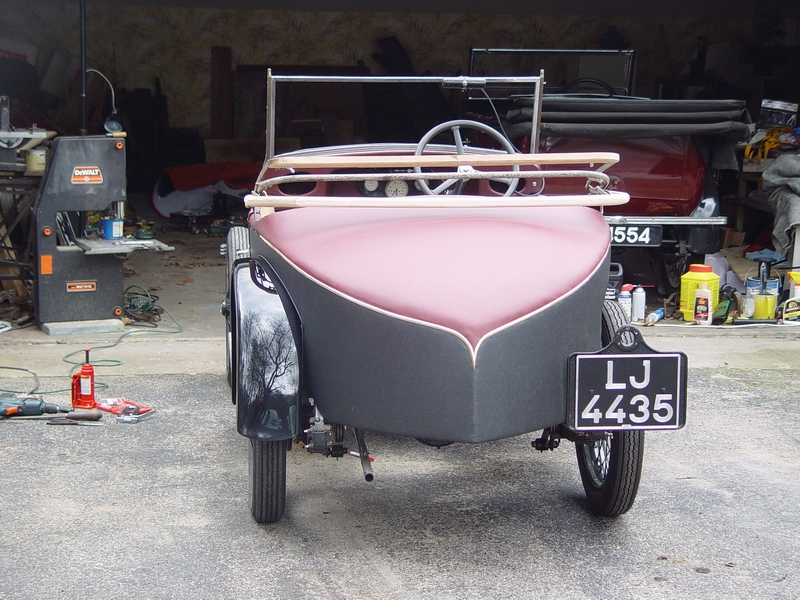

You are dead right - here's my garage back in Ada when the B-P was nearing completion, and with my '29 tourer in the background. Working against a deadline to get the car finished and shipped to the UK for Dorset, organization in the garage collapsed and it became a junk hole, and it took me hours to find the tool I needed. I learned my lesson - the new garage in Startup is currently pristine and I intend to keep it so. It does have the benefit of a proper work bench and yards of sturdy racking which will help greatly, but it will take discipline to keep it pristine in the heat of restoration. The worst part about the garage being so cluttered was that I would take my glasses off to see something close up, and an hour later, when I needed them there would be a sometimes very lengthy hunt to find where I had put them down.
