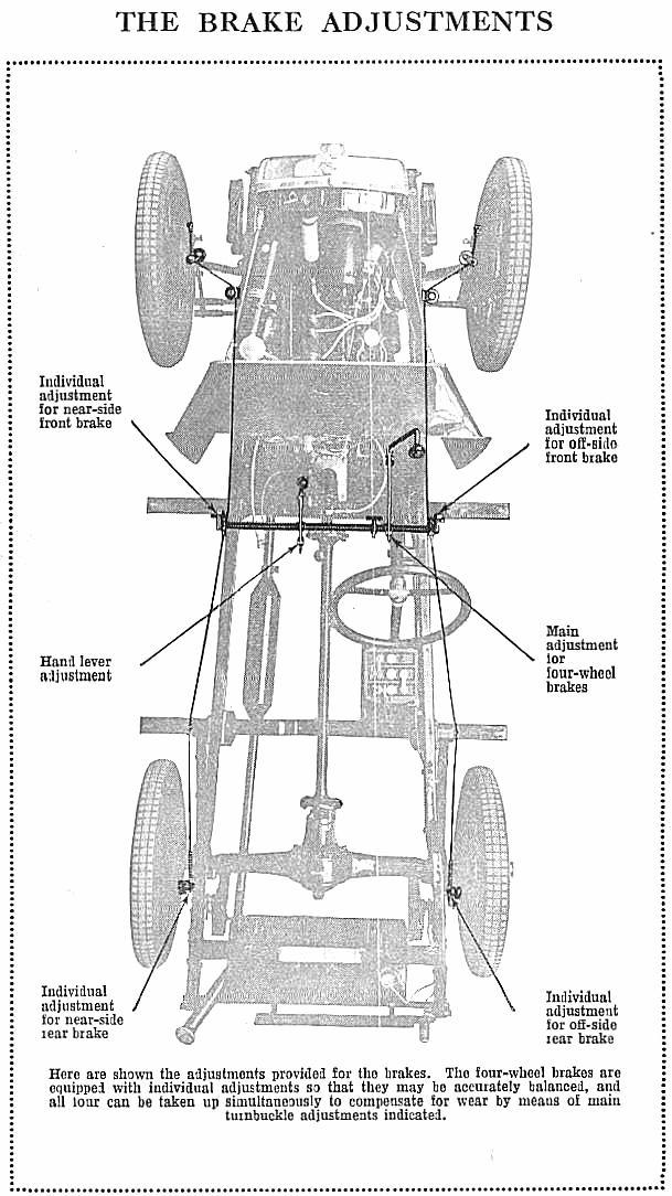

The only adjustment you have is the four cable lengths and the pedal to brake cross-shaft rod.
Here's the brake adjustment data from the 1933 Operator's Manual:
All Morris cars have their brakes properly balanced and adjusted before they leave the Works, and all Morris Dealers have instructions to see that they are properly adjusted before the cars get into the hands of owner-drivers. During the first 500 miles, however, the maximum braking power may not be available, and adjustments may have to be carried out by the owner in order to take up the natural surface wear inevitable with new brake linings.
Brake adjustments are of a very simple nature, and take the form of a main adjustment by a wing nut situated at the end of the brake pedal pull rod. This adjustment is revealed by removing the floorboard just in front of the driver's seat. Tighten-ing up the wing nut will cause all four brakes to be taken up simultaneously.
It is important with any system of four-wheel brakes that the pressure on all four wheels should be equal-that is to say, that when the pedal is depressed one wheel should not be braked more than is another, and therefore the careful owner will, after the first 500 miles, carry out the following procedure.

If when on tour (or almost at any other time during the life of the car) the foot brakes should require adjustment, this can very simply be effected by means of the wing nut previously described. Do not forget to take up the wing nut adjustment of the hand brake a like amount whenever use is made of this main adjustment, or you may find your hand brake ineffective.
It is important that during the life of the car the oiling nipples on the brake countershaft should receive a proper charge of oil at intervals of 500 miles.

Having read the bit about jacking up all four wheels, I prefer to adjust the brakes on the road. Take the car for a short trip up the lane and apply the brakes a few times. Then feel the warmth of each drum. Slacken off the warmer ones, tighten the colder ones and repeat until all four brakes are equally pulling their weight. Then repeat every few hundred miles, or as necessary.
You can obtain all the parts you need from Mike Dowley at Sports & Vintage Motors (01939/210458). He has brake cams and cotters, fulcrum pins, bronze bushes, pull-off springs, linings and rivets. (Please mention the VMR when calling S&V - Mike is a long-time sponsor of the Register, and we could not run our cars without his parts support.)
