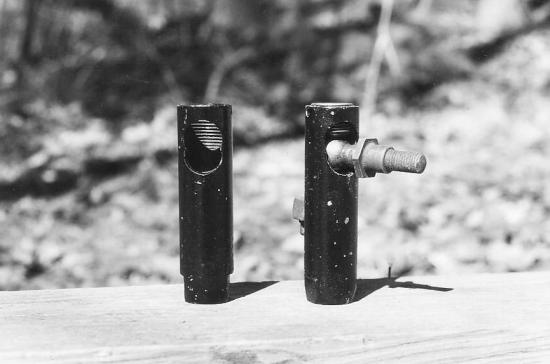

Terry Synott and I compared track rod ends last week end, and decided that both sets had a fair amount of wear. What is difficult though is judging how much is acceptable! To err on the side of safety I obtained a pair from S&V, shown in the attached picture for comparison. Hope this helps.Regards to all,Mike.
- note the straight sides!
- General pics 006.jpg (55.92 KiB) Viewed 5718 times

If this is a new one from S&V then it isn't a keyhole shape is it. Mike, any chance of you reporting the dimensions of the oval?
Re: Track rod and drag link ends
From the picture of the original ones up above, it looks like there were two overlapping circular holes - one slightly bigger than the other - drilled in the barrel to produce the keyhole effect. Seems to make manufacturing sense. The larger one needs to be just bigger than the ball, so it can be fitted, and the other one smaller, but big enough to give good clearance to the neck of the ball.

Its difficult to be completely accurate with the dimensions with the pin in the way, (and no desire to take it apart!). However the length appears to be 0.975", the wider width, 0.675", tapering down to 0.6". Hope this helps,
Mike.
Mike.
