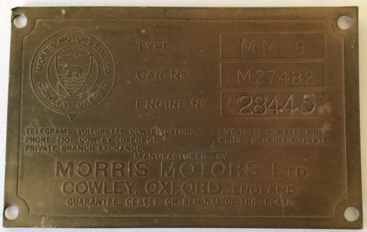

I have been carrying out a great deal of research into Minor (and M Type) chassis identification plates recently, and the results will be summarized in a major article the spring Magazine.
During the course of this research, I have been gathering images of many plates and it turns out that there are at least six variants covering OHC and SV Minor production.
Interestingly, as for the type of plate fitted to LJ 4435, I have found no other like it. I would suspect it as being a reproduction, but even the closest scrutiny of it shows no indication that it is not genuine.
Does anyone else have a chassis plate of this pattern, around this chassis number?
Re: LJ 4435
So one other identical plate has surfaced - that from M27482. Any others out there around these chassis numbers?

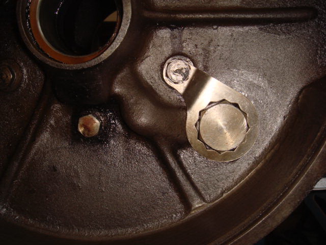

I suspect (and hope!) that the oil is escaping from the oil gallery plug in the bellhousineg - the one in behind the flywheel. I have therefore ordered a new plug and copper washer from Mike Dowley and also a special lockwasher that is a useful mod. to help keep the plug tight. I have also ordered a pot of special sealant that Mike recommends is used when fitting the plug.
Paul Ellis is the current holder of the Register's flywheel puller, so he's also sending that to Tarlton, where the car is currently being looked after by Peter Balding and John Stubberfield. (The puller is available for loan free of charge to any member in need.)
Once the parts have arrived, I'll then need to get the car to a workshop where the gearbox and flywheel can be removed and hopefully have the oil leak sorted.
Here's the rear plug lockwasher mod:

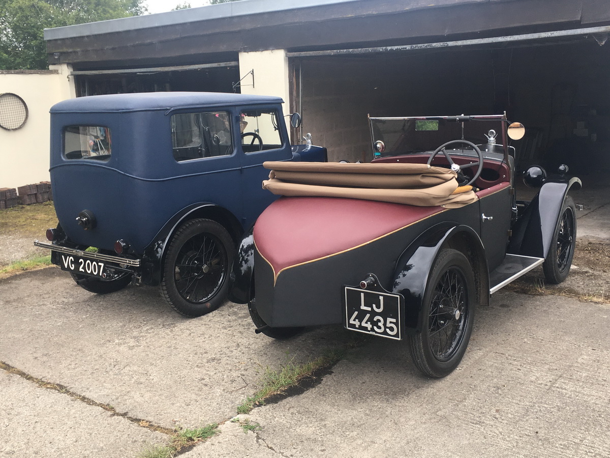

Update August 2022.
Just back from four weeks in England, during which I had time to collect the Semi-sports and it now lives alongside the fabric saloon which I also collected from Tony Gamble in North Yorkshire on the trailer I bought last year.
Very pleased to report that, after about 100 miles of motoring, there's no more oil leaks.
However, towards the end of the trip, a loud, intermittent screeching was isolated to the vertical drive, where the bearings are revolving in the housing. Something to sort out over Christmas during our next visit when I will get the head off and investigate.
But the good news is that the car is driving superbly - even with the loose vertical drive pinion and it was tracked using a GPS app at 41 mph on the A456, and without really pushing it.
On another amusing note, when I trailered the car back from a Cotswold run after the summer rally, the driver's side floorboard disappeared - probably somewhere along the M5! Luckily, the floorboard is exactly the same as that in the fabric saloon, so I swapped the floorboard between the cars, depending which I was driving! I brought the fabric saloon floorboard back to the USA and have made a copy to bring back with us at Christmas.

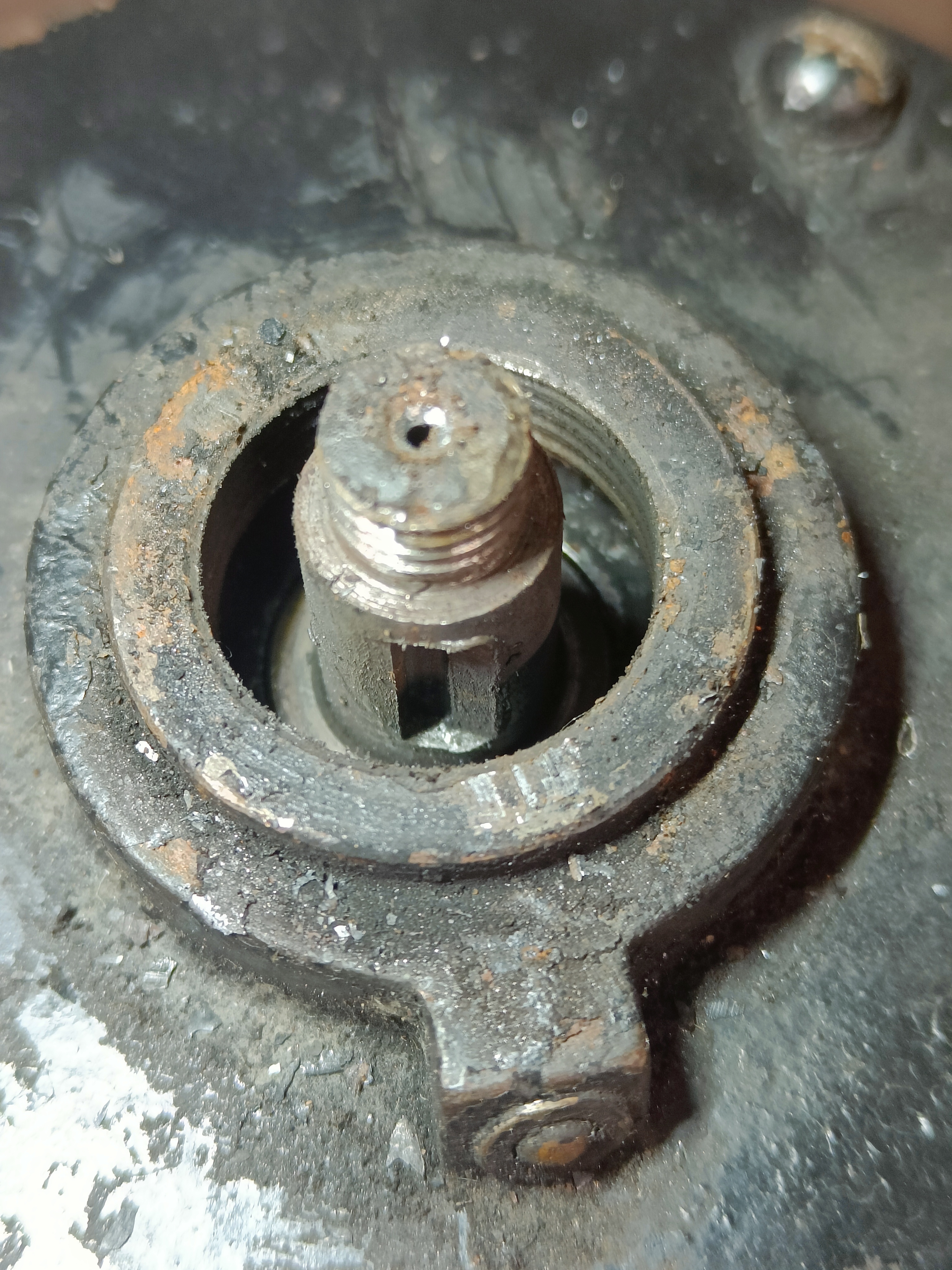

Re: LJ 4435
So I found the problem, which the following photos should show clearly:
Clearly the dynamo armature and fork keyways are shot. Additionally, the armature is several thou undersize so will need metal spraying and grinding back to 0.500". Two new forks and also a new vertical drive pinion will be ordered from Sports & Vintage, and while I am at it, I'll be centring the whole vertical drive with the dynamo. I'll do this by replacing the two stepped head studs (front left and right rear) with un-stepped studs so I can move the hear around slightly to line things up using a 1.375" mandrel in the head with a pointer which I'll line up with the pip on the top of the armature while turning the engine over. I suspect that a misalignment was probably the cause of the trouble in the first place.
I'll also replace the dynamo top bearing with a new sealed unit.
An article on overhauling the dynamo armature will appear in our Summer Magazine, and one on centring the whole dynamo/vertical drive pinion will appear in the autumn issue.
