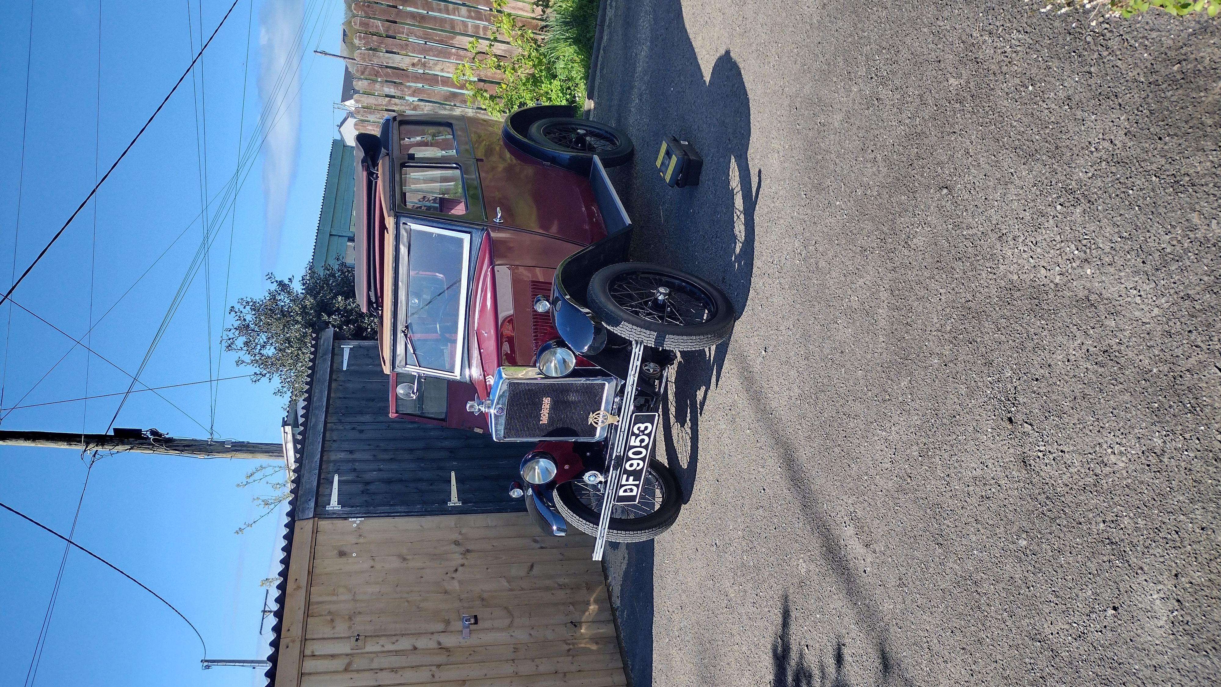

So after a long time but not a lot of miles DF 9053 is back in my garage.
I have sorted a raft of small issues and added rear indicators. The biggest problem was the dynamo though - not charging at all. So I have taken the radiator off, and the dynamo out. I then got struck down by flu and it seems some three weeks have gone by since I looked at it!
I have all the replacement parts, so next time there is a dry day and I'm not booked by parents or children I'll start to put it all back together again.
Hopefully in time for the Ludlow event if not before.
Cheers Jeremy
