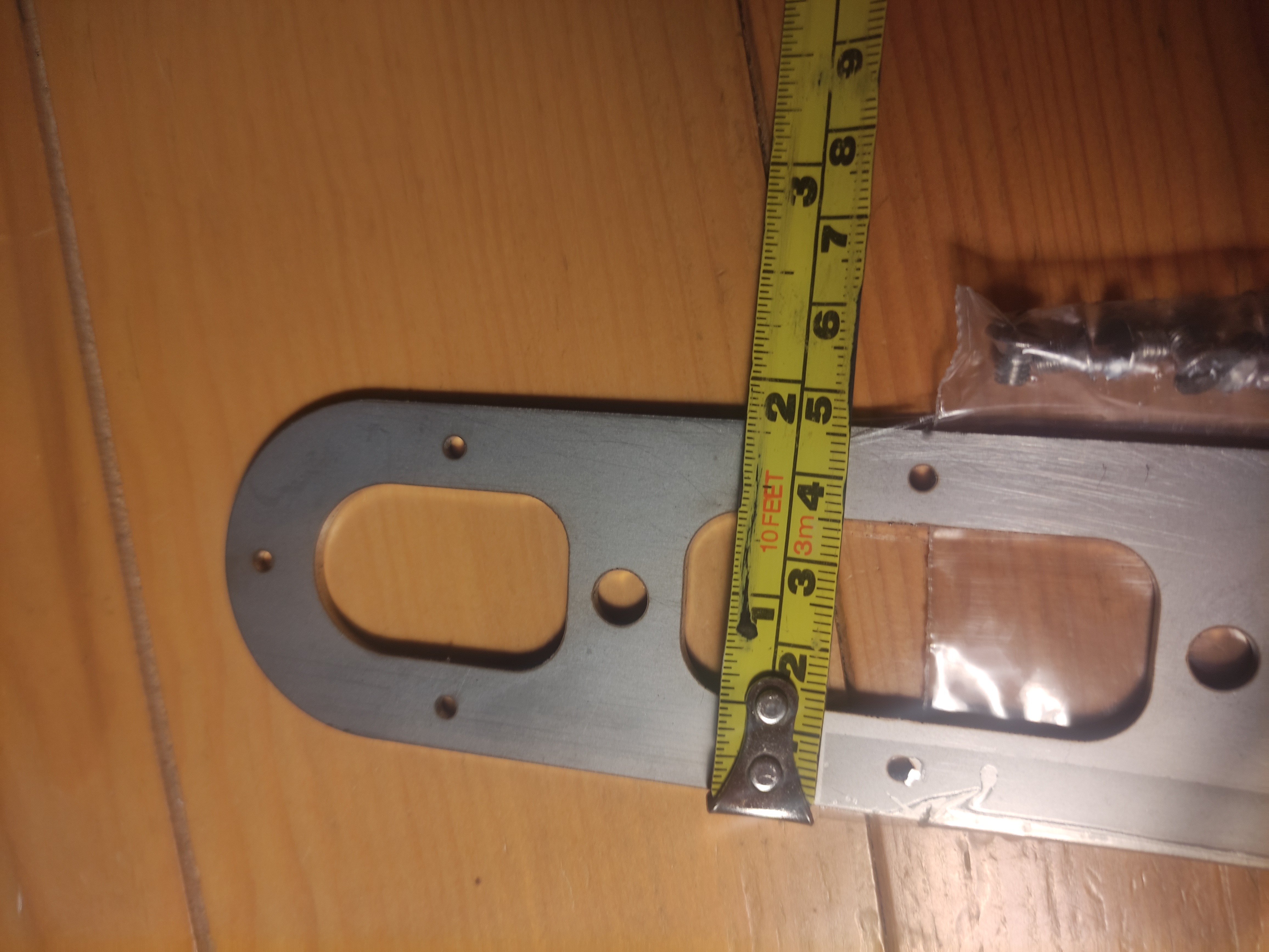

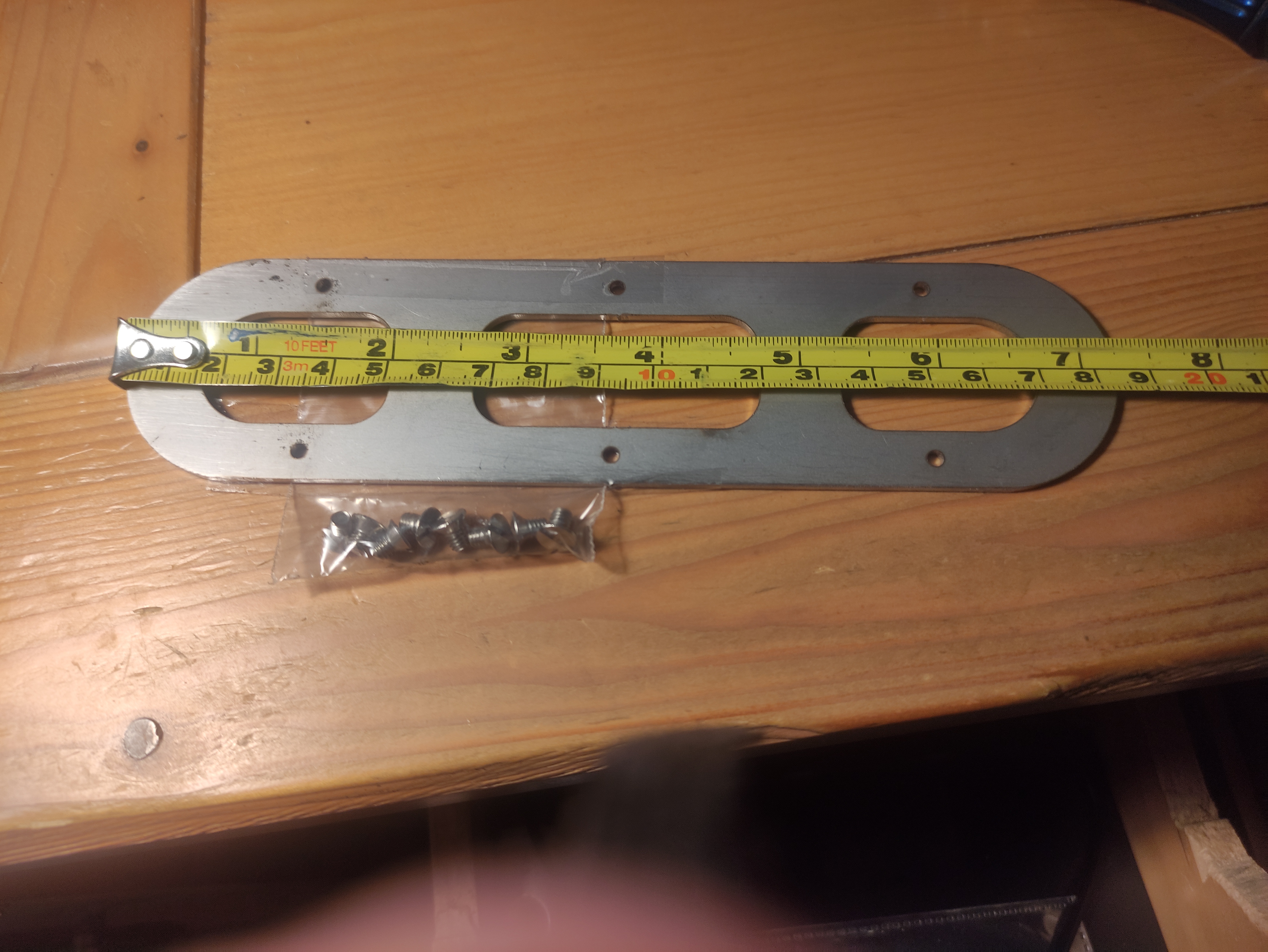

Austin 7 plate
Re: Morris Minor Special SV14930
Hi Trevor,
Good to hear from you.
I corresponded with Ian Harris who happened to have an Austin 7 water inlet and he confirmed the dimensions are the same as the SV Minor, so we cal all go ahead and buy these plates rather than having to make a special batch. I will be ordering one today. Ian Harris has the gaskets.
