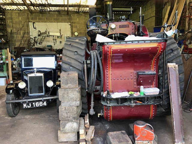

Good to see the saloon up and running under new ownership.
Featured on the VMR home page.
Posts: 5047
Re: Two Door Saloon (OHC) KJ 1664
That is a cracking photo! 8 horsepower meets the iron horse! And I love how the Minor gives scale to the beast.

Hi, Andy here. New owner of KJ1664. The 1907 Marshal General purpose traction engine is also rated at 8 hp. Steam rating must be different for steam.
The chap I got the car from had it started it with Easy Start. But when I went to look at it, it did not want to start and the seller was going to go and get some Easy Start. I said no, get some cheap hair spray - much easier on the engine but just as effective (I learnt that trick in France, starting tractors) so he tried it and it fired then stopped. We found that there was no petrol in carb. and traced the problem back to find the fuel tap off. We turned it on, pushed in fuel knob and it started first try. It’s had a new coil ,plugs and HT leads so maybe that was why Philip had no success.
