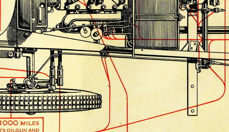

Re: More brake cable questions
Richard,
Bit of head scratching going on here, but I might have got a clue from your first photo from yesterday.
There were two different chassis pulley brackets on Minors. I have been trawling through my images trying to find a photo of the early type, but without success so far. But it can be seen quite clearly in the 1931 season lubrication chart:
Note also that the pulley wheels were of a smaller diameter. This is the system that your chassis SV8159 should have, but it appears that it has the later bracket and pulleys.
The early type bracket shown in the drawing above (Morris part no. 5133) started on the OHC Minor at chassis M29528 and on the SV Minor from SV101, and ran through to SV chassis SV20300, i.e. the end of 1932 season production. The later, stronger type (Morris part no. 50396)ran from chassis SV20301 to SV33778 (i.e. the 1933 season).
So you have 1933 season brake brackets and pulleys on your 1931 season chassis.
According to Brivec, you should therefore have the later brake cables, which I believe switched from chassis SV20301, not SV13542 as stated in the Brivec catalogue. I looked up SV13542 in the Genome and it is in the middle of a batch of saloons of no particular note that were laid down in the middle of February 1932.
The reason for the upgrade was to introduce stronger brackets and larger diameter pulley wheels, thereby requiring longer cables.
The two types of bracket were attached with a different bolt arrangement. The early bracket simply had a pair of bolts (and therefore bolt holes in the chassis) that were side by side. It would be interesting to see if there is any evidence of these holes in your chassis. If not, then I would double check the chassis number on your chassis dumbiron, and whether the dumbiron is attached with its original rivets or has been bolted on from another chassis. (Chassis SV8159 left the works as a bare driving chassis, so presumably your tourer body is Australian-built?)
But for now, the question is - would cables that were 1.75" longer still be too short?
