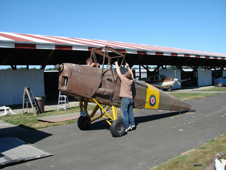

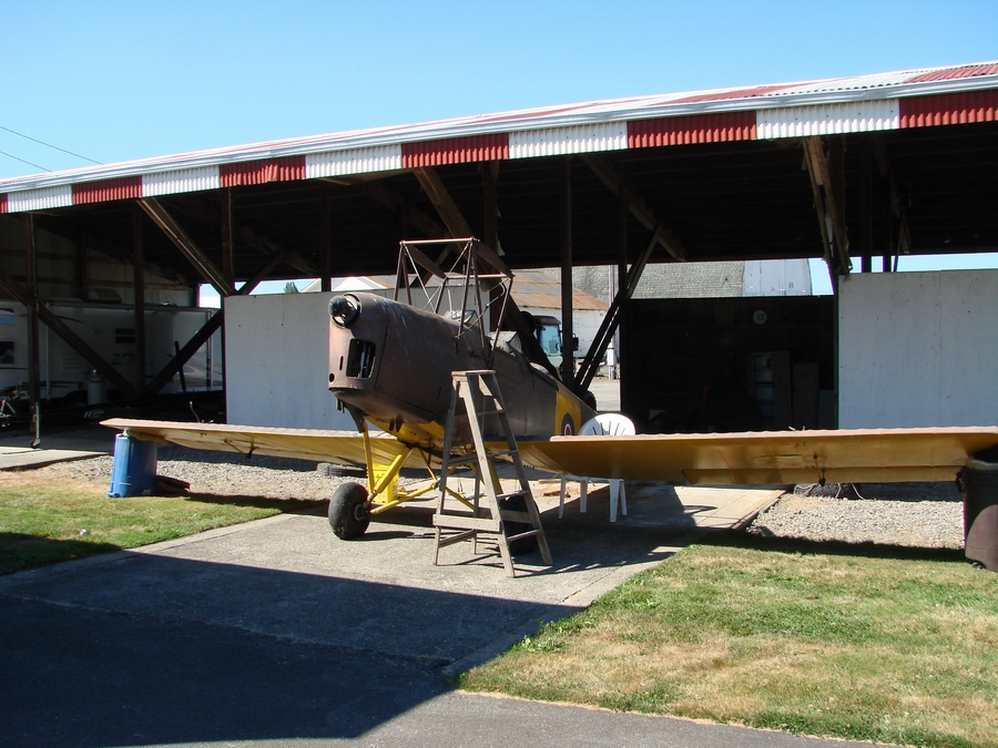

Today I completed the removal of the tail feathers and then removed the prop hub front plate and spinner with a view to removing the wooden prop. The prop has been exposed to the elements in the open hangar for several years and has split and cracked - so is scrap. Upon delivering a good slap behind one tip to shift the prop off , the last six inches or so broke off! The wood was found to have the consistency of Balsa wood - completely rotten. If the engine had been started, it would certainly have disintegrated into a million pieces.
The next job was to remove the stout split pins in the pins and bolts holding the lower wings to the fuselage. The front ones are absolute buggers to get to - lying on your back under the fuselage. Nearly an hour later, I had them both out. Now the lower wings are ready for removal. Next will be the top wing bolts and all the flying wire split pins. Photos next time.

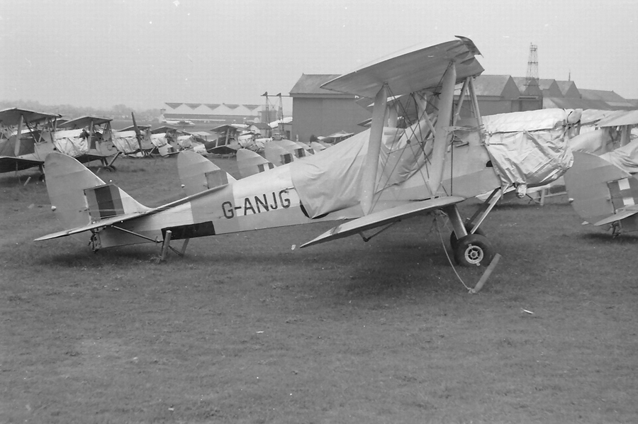

In the fifties, hundreds of surplus Tiger Moths were acquired by Whittemores and Rollasons at Croydon. Many were restored and became the backbone of post-war civil flying clubs, but many, many more were simply burned.
Here are just some of them staked out at Croydon in 1953. There was a gale one night and many Tigers were swept onto Purley Way and destroyed.

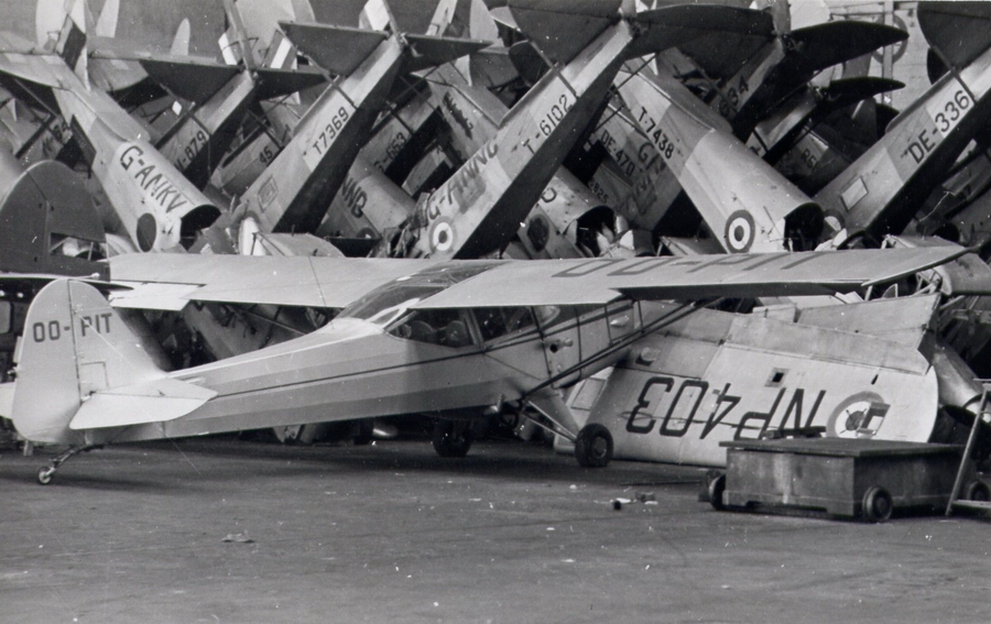

And here is a view inside the Whittemore hangar. I am scouring similar pictures for a glimpse of N-5490 which became G-ANHG before being exported to a French flying club in 1955, but no luck so far. This little lot would be priceless today, but were sold - after overhaul - for around GBP 20 each back then ...

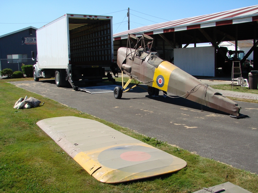

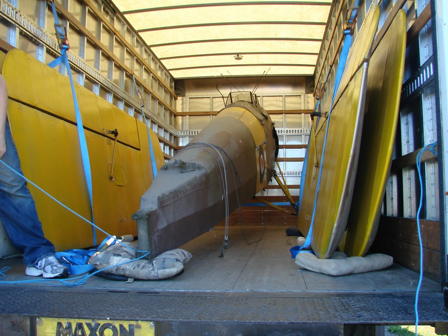

The third of September - what more appropriate day for arranging the collection of the Tiger. War in Europe was declared this day in 1939. On that day, this Tiger was relocated from Gravesend to Castle Bromwich near Birmingham as the RAF moved a fighter Squadron in to Gravesend to protect London and the East End docks. Castle Bromwich was also soon to become famous for its massive Vickers aircraft factory which became the main production works for Spitfire production, not to mention many hundred Lancaster bombers.

And on the left you can see the old VMR printer - through which every Magazine and Yearbook passed before the new style M 138 appeared.

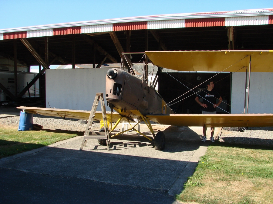

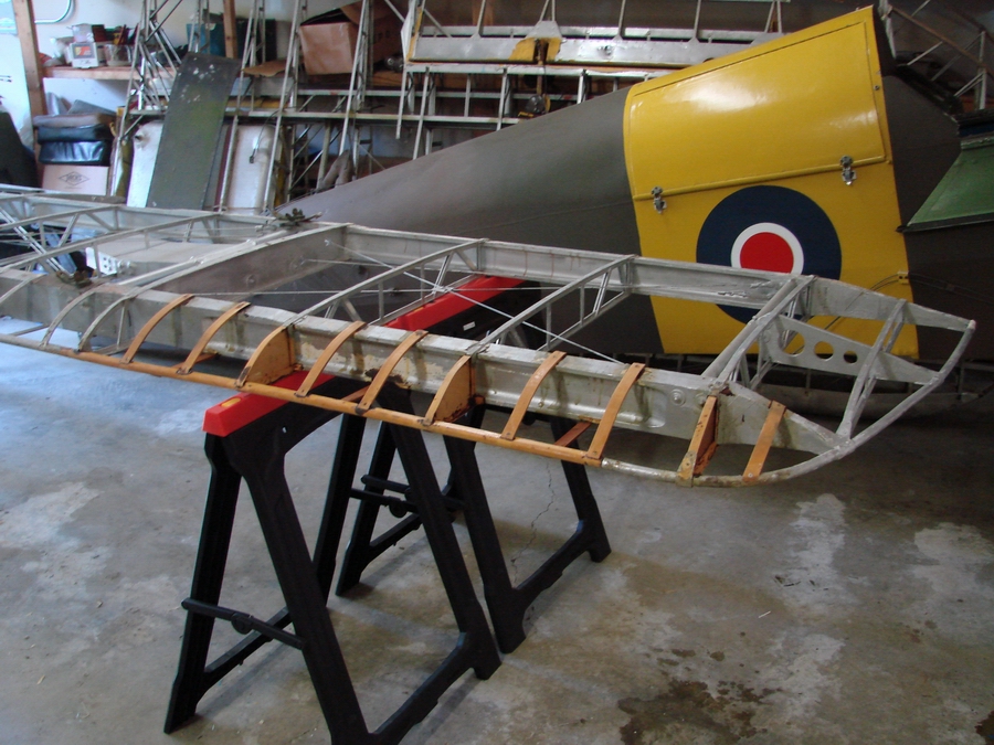

Bit of an update. All four wings are now stripped of fabric for inspection. Here's the port lower showing a pretty ugly (isn't that a contradiction in terms?) repair to the leading edge - necessitated by damage caused during one of the previous owner's various excursions through the hedge. Behind the repair there is a three foot long crack right through the front spar which was obviously missed when the repair was made, so the spar will require replacement, as will the front spar on the starboard lower which has some nasty non-approved gouge repairs. The upper wings are in better shape, just needing some ribs to be replaced and all the metal fittings removed, cleaned, re-protected and refitted with British BSF bolts replacing all the American AN stock currently installed.
I'll completely overhaul each wing in turn, then store them in the basement until the rest of the aircraft is ready and then do all the fabric work in one go after a trial rigging to check everything still fits.
