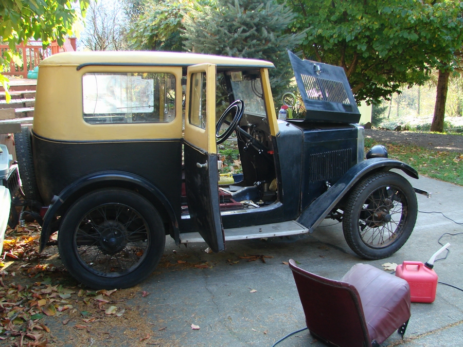

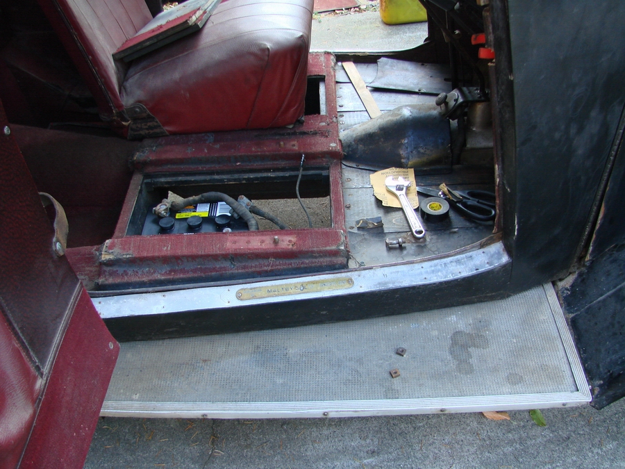

I had hoped that I might get to fire her up today, but it was not to be. First job was to drain the old fuel. The fuel tap was solid in the OFF position, so had to be removed. Then I removed the driver's seat so I could clean out the battery box, clean the terminals and fit the new battery. With the plugs out, the engine revolved nicely on the button, and the oil pressure rose to 65 psi. But with the rocker cover off, no oil flow was visible to the cam gear - oil is not reaching the head. The other problem is that there is no life in the ignition circuit - no glimmer from the warning lamp (might be a blown bulb), but also no flicker from the ammeter. I think I am going to have to re-wire everything - the original 1930 wiring has probable had its day! I'll also remove the oil pressure pipe to the head and see if oil pours out when operating the starter. If so, then it could be the restrictor pin gummed up. The bottom hose is also completely brittle and broken, so I'll replace both hoses and flush the radiator and block as much as possible before attempting a firing up.
Re: KR 5670
Nice to see some progress though Ian, good to hear that it span over ok, and with oil pressure... mind you, a blockage to the head would increase the reading..... 65 psi on cranking would be far more than expected... so there must be a blockage somewhere..........
I would be more impatient than you, I'd rig up temporary wiring to simply get it running.... it wouldn't take much!
Re: KR 5670
Took the restrictor pin out - cleaned it, refitted it. Cranked it over, oil oozing slowly from the holes in all eight rockers. May improve when running and warmed through. I'll dowse the rockers with fresh oil before trying to fire it up. Removed both hoses - they were completely brittle and crumbed away. Used the garden hose to backflush the radiator and block, now have big orange stains all down the drive! Yes, I'll ,probably run a cable from the battery to the coil and see if I can get it running!

Just noticed that the floor on both sides of the gearbox are a bit higher than on VG :?: :?:

Well spotted Halbe - hadn't noticed this - Minor front floor boards should be an inch or so below the level of the sills. Not sure if this is a Hornet body feature. But the gearbox cover seems to be about the right height in relation to the starter button, so maybe the sills are thinner?! Seems unlikely, but something doesn't quite add up here. I'll take a closer look tonight and report back.
Edited to add - the front seats are also raised on pairs of wooden runners, which look original as they are under the original carpeting. Maybe so the driver could see over the longer bonnet of the Hornet? :D
