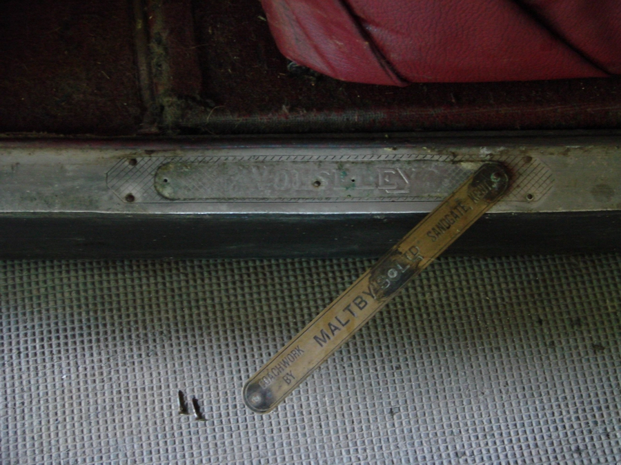

Well, Simon's hunch was absolutely spot on!
Under the Maltby threshold plate is WOLSELEY!!!
So this IS a Hornet body, Hornet bodies ARE identical to Minor bodies, and they DO fit exactly on SWB chassis! And the mustard-coloured superstructure was painted by Wolseleys - as with most - if not all - of the early Hornet saloons and fabric saloons.
It must have been that someone had a Hornet saloon, wanted Maltby to fit a sporting body, traded in the salon body, then Maltbys bought a (cheaper) Minor chassis and registered it locally as KR 5670.
This bring to an end the enigma that has surrounded this car for very many years. And I guess this has to be the best-preserved Hornet saloon body in existence.

And it also makes sense that Maltbys would have fitted their coachbuilder's plates, even thought they didn't build the coachwork, simply to cover up the Wolseley lettering - 'cos it isn't a Wolseley!
