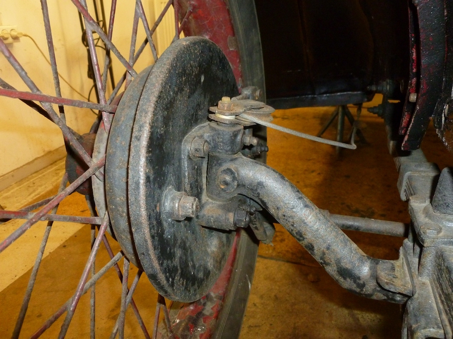

Here's the photo of your front brakes that you sent me:
Yes, this roughly like the original set-up. However:
1 The brake lever should be in front of the kingpin and not behind it. You can either remove the brake cam and the hinge pin from the back plate and swap them (the two bronze bushes in each backplate are identical), or you can put the left backplate on the right and the right on the left, which will be the same.
2 There should be a second pulley, in a bracket, attached to the chassis. Do you have these?
3 The cables you have are far too thick for pulley brakes, as they need to be very flexible to run around the pulleys. The original flexible front brake cables were made of wire rope and not cable, becuase wire rope is much more flexible.
I will contact Ian Harris to see what he has in stock right now and to talk about having some SV kingpins made. I need a pair myself - does anyone else need any?
It is difficult to see in this photo, but it looks like there is no alloy wedge between your front axle and your front spring? It is a vital part if you want ther steering to work!

Re: Were can I find king pin to a 1931 SV?
Interesting!
Well, I have had a feeling that someone has "tried" to put the car together without Minor knowledge - but this is what I have to work with!
1) OK, this seem rather easy to manage.
2) No, don't think so. I'll examine this - I found a picture showing the SV chassie and those are missing.
3) Dimension?
4) Yes, it would be very nice if the steering is working
I will send you a better photo.
At a second thought - I'll send you some more photos of the car for your comments - if thats OK with you?
Thomas
