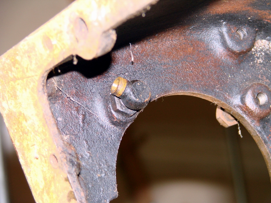

A bit more. It appears that the replacement of the rear roller is only half of the modification. I have found that the block has been modified slightly to take a small-bore copper pipe, internal to the block, from the front of the engine to the rear main. It is not easy to photograph, but here goes:
Here's the pressure pipe union at the rear end which the internal pipe attaches to.

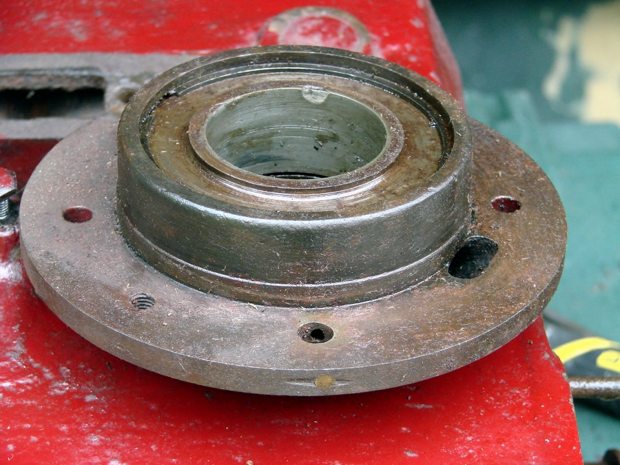

And here's the rear bearing housing - showing the solid, white metaled rear main and the drilling modification to take oil to the bearing from the union shown in the previous picture. This housing is attached with four bolts, and one has been enlarged to 5/16" and drilled to feed the oil to the bearing.

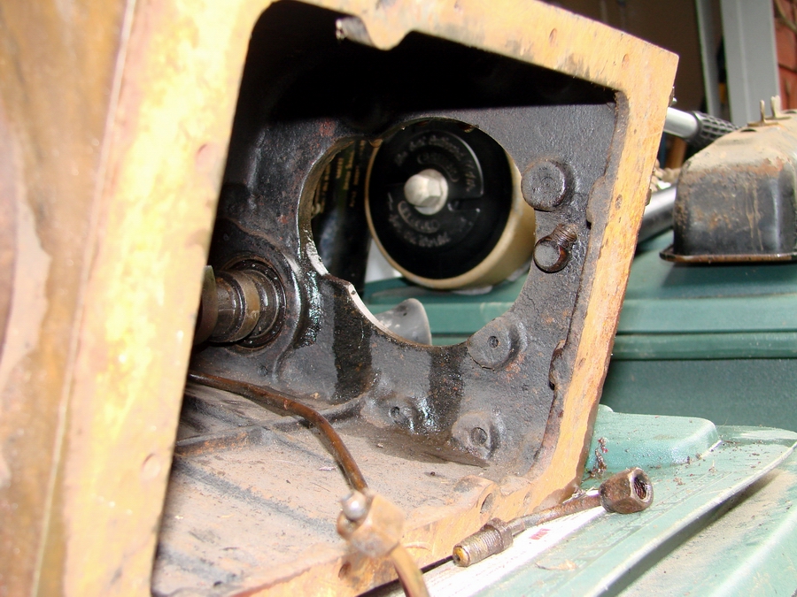

Here's the other end of the internal pipe at the front of the block.

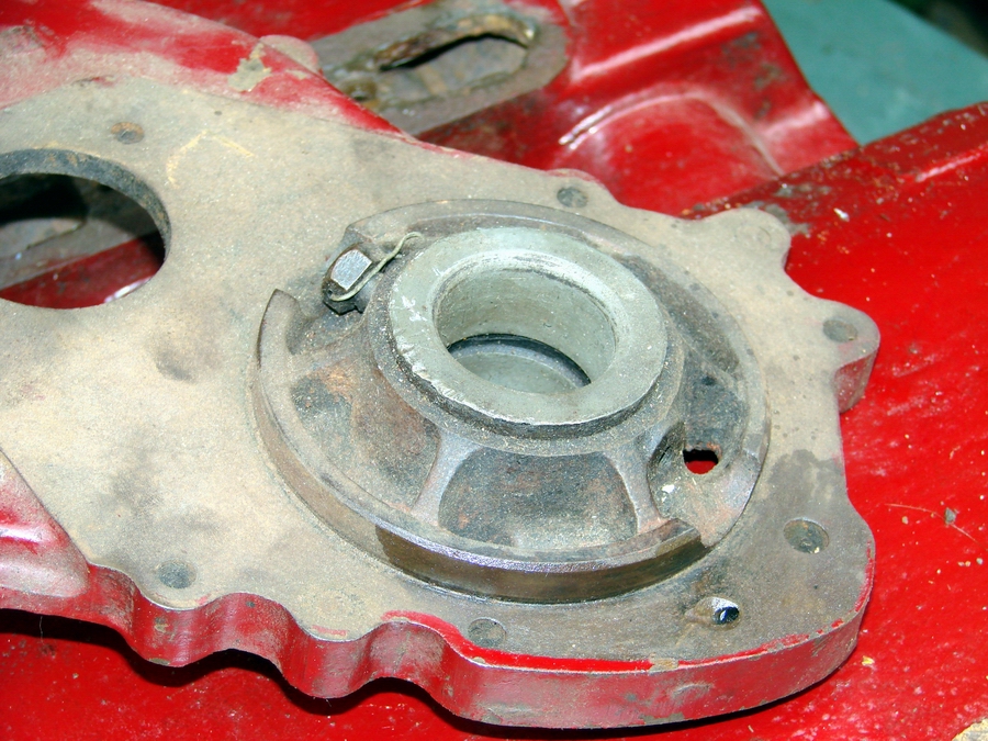

And here is the timing gear cover, also cleverly adapted to feed oil to the pressure pipe.
Has anyone ever seen anything like this on a SV engine? Could it have been a McEvoy modification? What advantage does it give over the standard arrangement - with the oil feed to the rear main coming through the crank - perhaps better pressure reaching the main as it is fed directly from pump pressure rather than what is left after the big ends have been fed? And presumably it would also serve to back-feed the crank, delivering more oil to all the big ends?
What is apparent is that someone has gone to a great deal of trouble to effect this modification, and it if wasn't McEvoy, then it is possible that someone was preparing this engine for competition. No competition record of the car has yet surfaced, but I'm keeping my eye out for any reference.

The oil pressure mod. certainly is ingenious and completely hidden inside the engine. I read somewhere recently that white metal is more forgiving than shells so is better able to handle crankshaft whip at high revolutions. Maybe that was what drove the rear main bearing mod, and then the oil mod. was needed to supply oil to it? I need to think some more about this.

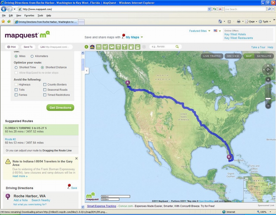

Well, here's an idea. VMR HQ is about 80 miles from Roche Harbor in the San Juan islands - which is pretty much the extreme north-west tip of the contiguous states - the so-called lower 48 (which excludes Alaska and Hawaii). The furthest point in the US from Roche is therefore Key West, Florida. According to Mapquest (see below) Roche Harbor to Key West – taking the shortest route, but not avoiding freeways – is 60 hours driving and about 3,500 miles. So probably 4,000 miles or so if avoiding most freeways. That would be about 70 hours, so double this for a Minor – 140 hours. 6 hours a day average perhaps. Or 5 hours a day to allow for some rest/maintenance days. So about 28 days in all, which is do-able. I don't think I would take the fabric saloon - even though it would be appropriate because of its past long-distance history, but the McEvoy would make an excellent mount - newly restored, and particularly with its long legs, four speed box and additional performance (I'd have to cross a number of mountain ranges, including the Continental Divide), etc. Now there's a restoration target to aim for.
