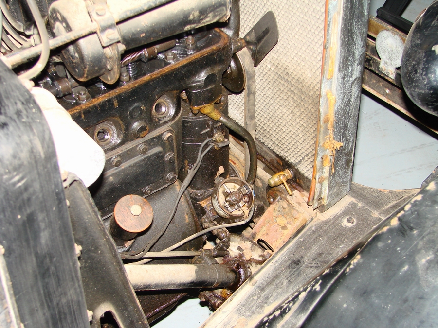

Spent a couple of hours on the Molseley Minet today - starting to get it ready to fire up. The longest job by far was sorting out the radiator drain tap. It was solid in the radiator and took a considerable amount of effort and bashed knuckles to get it out without jamming a spanner through the honeycomb. It had to come out because the tap lever was also solid, and the brass arm was threatening to bend as I tried to operate it. With the help of WD40 it is now sorted and re-fitted. I need to make sure the entire water system is watertight and filled before thinking about starting her up.

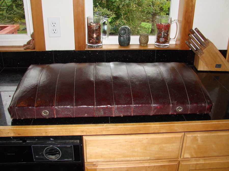

I also took the back seat squab out which was covered in thick dust, and gave it a buff up. It doesn't look like anyone has ever sat on it. The view below shows the seat from the rear, revealing a pair of turnbuckle fittings on the back edge - but there are no corresponding turnbuckles behind it. And in any case, how would you operate them - the turnbuckles would have to be inside the seat! Obviously original, but what could their purpose possibly be? Presumably for ventilation - to let air out as you sit on the seat. Has anyone else got an original back seat with this feature?

The image below shows the general state of the car under the bonnet - lots of dirt but basically sound. Another plus is that the oil is clean and new - must have been changed very shortly before it last ran, so there is no water, acid or other corrosive gunk in the sump. But I will be draining and refilling anyway, and I have a good original under tray to fit at the same time.

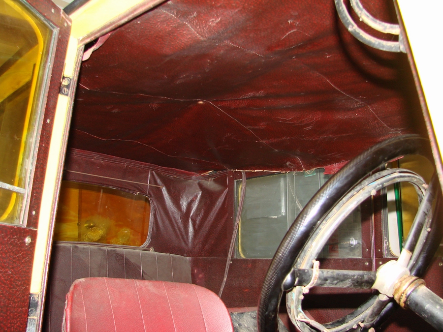

This question still nags at me every time I go into the garage - how far to go with the restoration? The interior is a problem - the original headlining has shrunk a good inch or so in width (see third picture below), so it has pulled away from the sides and is hanging down a bit. There is no way to re-fit it, so the interior is original but tatty in places. I'm sure I could get the car driving as it is, without any obvious restoration, but the coachwork, seats and interior - not to mention the exterior fabric - would be terribly delicate and would deteriorate rapidly if used more than once in a blue moon - which just isn't my style. If it were to be restored faithfully, what better starting point of reference than a car that is virtually completely original and mechanically virtually unworn. So do I go down the Halbe route and end up with a fully restored car - as close as possible to the original specification, or preserve it as a rolling museum time capsule? It is a VERY difficult decision and everyone's views would be very much appreciated. I wonder what Olive Willats would have suggested ... :?

Ian, the turn buckle holes aren't there to be used as turn buckles, they are there simply to let the air out of the seat when you sit on it, otherwise with the carhyde being air tight, its basically a giant whoopy cushion...........!!
And as far as restoration goes, you're the only one that can make that decision, but if it were me, i would take hundreds of pictures for reference, then on the interior make at least a new headlining, as its not useable as it is........ then get the car useable with original exterior fabric etc, and as and when it becomes in need of redoing, do it in stages........ that way it never becomes a full on project, and you should be able to keep using it as you do jobs..... and as for what Olive would say........ well, she used the car didn;t she? so there's the answer!!
