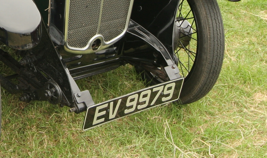

Before I remove the radiator; does anyone have a photo that shows the 'shape' of the glass-fibre panels that cover the Dumb-irons and underneath the radiator (1933 SV). I have the fibre-glass pieces that cover the top + sides of the dumb-irons. I will be able to reconstruct these but I do not have the piece that goes underneath the radiator. It looks like this piece is attached to the two dumb-iron covers?
Re: JF 4238 1933 Minor Saloon
John, here's the '33/'34 front valence - different to all earlier ones to accommodate the lower radiator shell of the '33/'34 cars. Plus it is louvred - unlike the earlier ones. I actually need one myself for the McEvoy - so maybe we could have some made? I think fibreglass ones are available, but I would prefer steel myself. We would also need to borrow a good pattern from someone. Any offers out there? And then select a suitable company to make them up - someone like the Cooke Group or Vintage Radiators?

Now that looks a lot more complicated than I thought it was going to be. The 'pieces' that I am left with suggest a much simpler component, unless they are not original? I am not planning on spending much to sort these out, will probably use these pieces + some fibre glass. Not sure how I will make the louvres.
Dumb Iron Covers.jpg (78.17 KiB) Viewed 4079 times
Nothing in your photo looks faintly original - even if they were steel! The simplest thing to do is make a flat, rectangular panel and screw it over the dumbirons, with a hole to take the starting handle. It will get you on the road and cost you nothing - two most worthy goals!

While I am on 'light duties' I might have a think about how I might fabricate a steel version, or a composite steel/fibre glass version of this panel. Does anyone else have photos that might help me? what is the height/depth of the panel with the louvres on? what are the lengths of the lourves?
I think I must be missing a starting handle support bracket that must bolt onto the front cros member - anyone got a photo of one?
